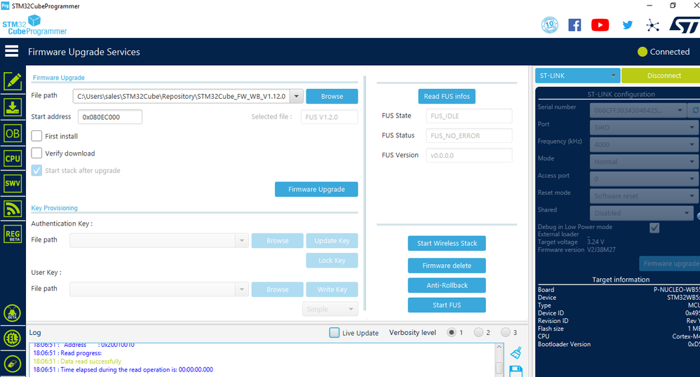

As per your suggestion i started FUS
after that i tried to delete so i am facing same issue, another thing we need to observe here that FUS version still showing v0.0.0.0

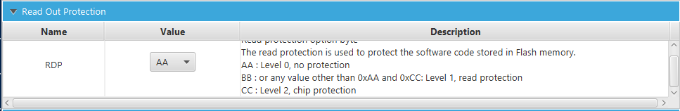

1) while going to option bytes it shows that check the flash protection, and another thing i am not able to connect ST-link utility

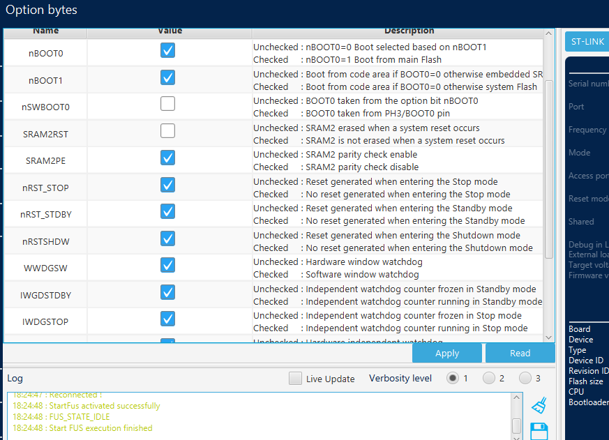

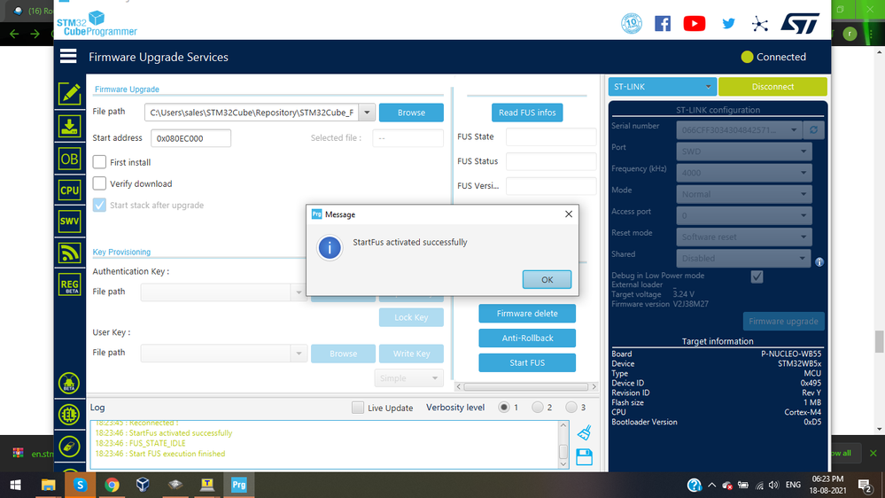

Ra.1
Ra.1Author
August 18, 2021
Hello houda,
this is the log which i got after updating
18:24:42 : Warning: Option Byte: nSWboot0, value: 0x0, was not modified.
18:24:42 : Warning: Option Byte: nboot0, value: 0x1, was not modified.
18:24:42 : Warning: Option Byte: nboot1, value: 0x1, was not modified.
18:24:42 : Warning: Option Bytes are unchanged, Data won't be downloaded
18:24:42 : Succeeded to set nSWboot0=0 nboot1=1 nboot0=1
18:24:42 : Memory Programming ...
18:24:42 : Opening and parsing file: 0x495_FUS_Operator.bin
18:24:42 :  File     : 0x495_FUS_Operator.bin
18:24:42 :  Size     : 8 KBytes
18:24:42 :  Address    : 0x08000000
18:24:42 : Erasing memory corresponding to segment 0:
18:24:42 : Erasing internal memory sectors [0 1]
18:24:42 : Download in Progress:
18:24:43 : File download complete
18:24:43 : Time elapsed during download operation: 00:00:00.280
18:24:43 : Application is running, Please Hold on...
18:24:43 : Reconnecting...
18:24:43 : Reconnected !
18:24:47 : Reconnecting...
18:24:47 : Reconnected !
18:24:48 : StartFus activated successfully
18:24:48 : FUS_STATE_IDLE
18:24:48 : Start FUS execution finished

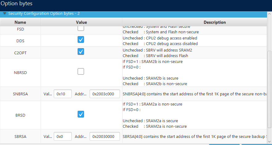

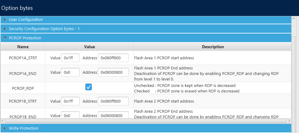

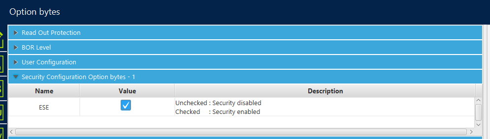

Ra.1
Ra.1Author
August 18, 2021
Hello all,
these are for the reference

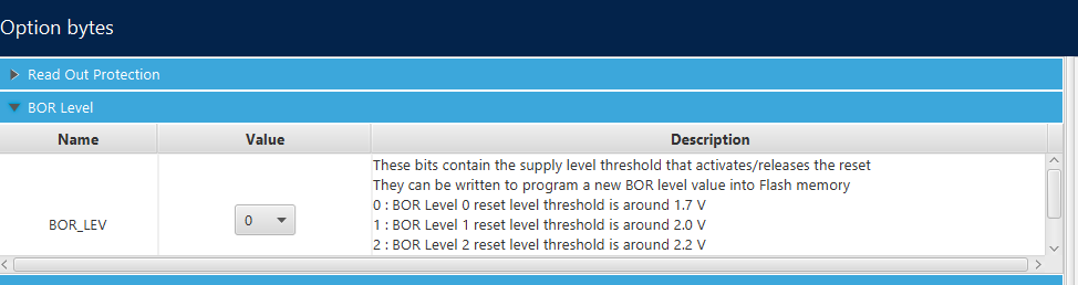

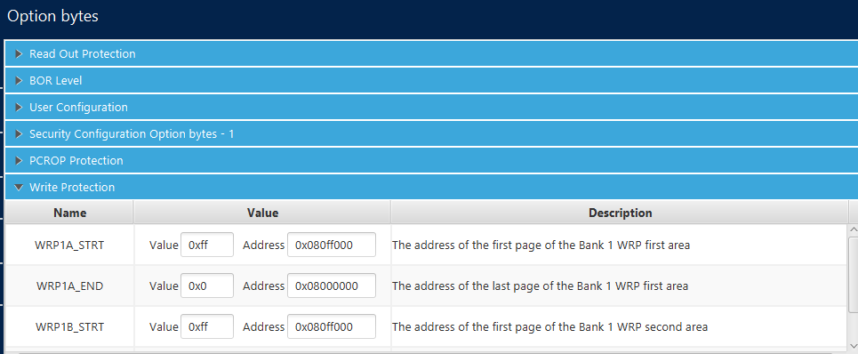

0693W00000Dph1VQAR.png0693W00000DpgzLQAR.png0693W00000Dph1LQAR.png0693W00000Dph1BQAR.png0693W00000Dph16QAB.png0693W00000Dph11QAB.png
Remi QUINTIN
August 18, 2021
Thanks for the download but I am just missing the 2 most important ones: SFSA and SBRV which are part of the security configuration. They do not appear on the first screenshot.

Houda GHABRI
August 18, 2021
Hi @Ra.1​
Yes the FUS seems to be upgraded successfully according to your traces so I eliminate a FUS version issue.
I will check with our experts what can be the reason to have this issue and come back to you with updates very soon.

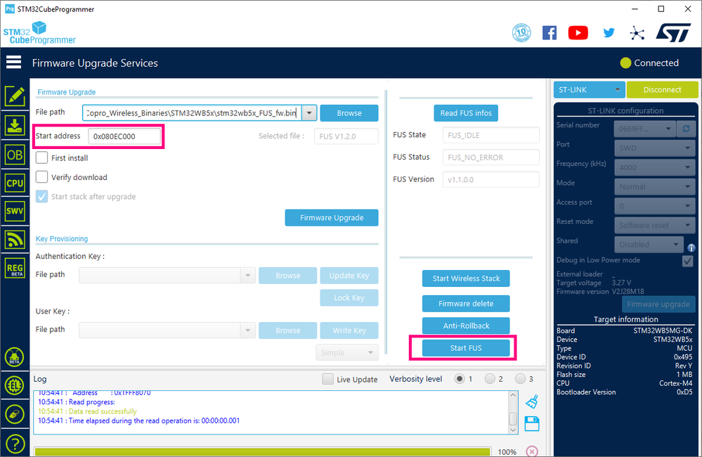

i have another STM32WB DK which is working so i connected and observed that the value of SFSA and SBRSA is differ from the current (which has issue) DK.
so i tried to change the value so it gave the error "option byte program failure"
Remi QUINTIN
August 20, 2021
The SBRV value is still missing but I have enough info with SFSA = 0xF6 to say that the FUS has never been updated on this board as this address is the one of the very first FUS version v0.5.3. At the opposite, the pre-installed FW has indeed been deleted.
From this constatation, I can say that you will never be able to upgrade the FW with this FUS version. You need first to upgrade it to FUS v1.0.2 first and then to the latest version v1.2.
Then you will be able to program the FW stack on your board.
So we have to focus first on the upgrade to FUS V1.0.2.

sorry for late response, i tried with both the files which you have suggested stm32wb5x_FUS_fw_for_fus_0_5_3.bin, stm32wb5x_FUS_fw_1_0_2.bin
but getting same error as shown in below screen shot
