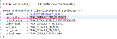

I created a project with cubeide 1.18.0 using stm32wba55. I am doing code generation but it gives crc_ctrl.h error while compiling. What can I do?

I am creating a client device using STM32WBA63CI. But it gives the following errors while compiling. I am generating code from scratch but it is not working.
Other problem is below. Could you help me please?

I didnt find in project files this crc_crtl.h.

How have you created your project. Based on an example or how?

No, I created a project from scratch

So, first try to update to the STM32CubeMX V6.14.1 and the STM32CubeIDE V1.18.1. After that, configure the project with the standalone STM32CubeMX and generate it to CubeIDE. If you still have an issue, please send your .ioc file (that you made using the STM32CubeMX V6.14.1).
