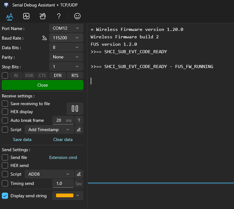

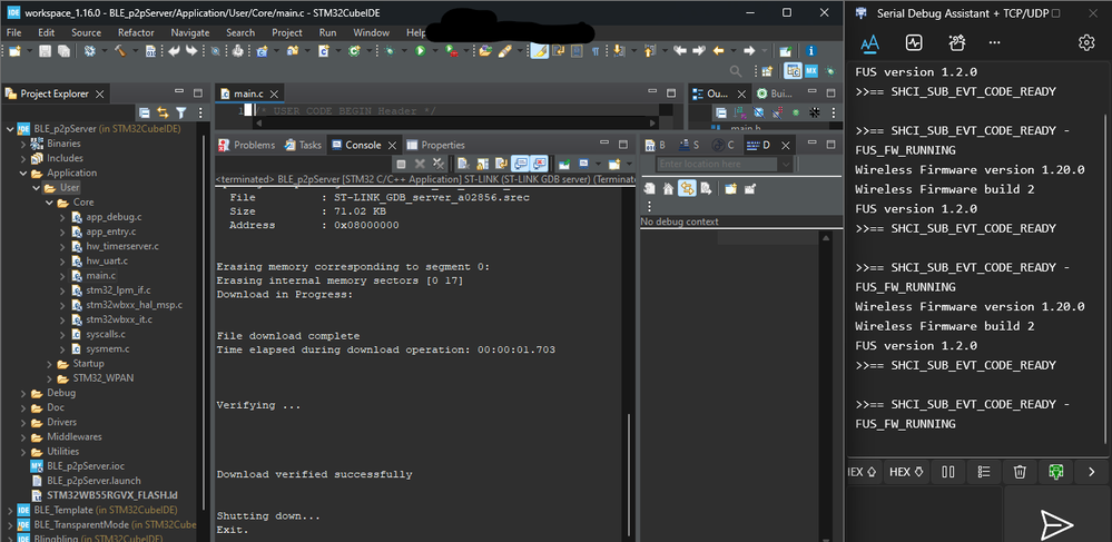

I have a problem STM32WB55RG, i download BLE_p2pServer firmware to the board and success in stm32cubeide, but board can't run the firmware and i try download with stm32cubeprogrammer and i have same problem.
maybe someone can help me..
Thanks

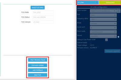

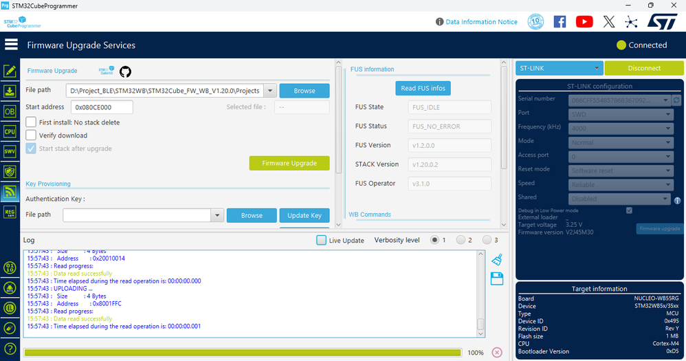

This application requires having the stm32wb5x_BLE_Stack_full_fw.bin binary flashed on the Wireless Coprocessor (available here). So, please do a Stack update with this .bin. Then, start the wireless stack using the button "Start wireless stack" on the Cube Programmer interface:
Then, it should work fine.

2024-08-06 04:51 PM
I have tried it but the problem still occurs on my device

Have you clicked on the button "Start Wireless Stack" after upgrading stack and firmware and before uploading your application. I think this is why you have this problem.

2024-08-22 06:31 PM
I have clicked on it
2024-08-22 10:49 PM - edited 2024-08-22 10:49 PM
Could you please try another board. It should be working fine.
