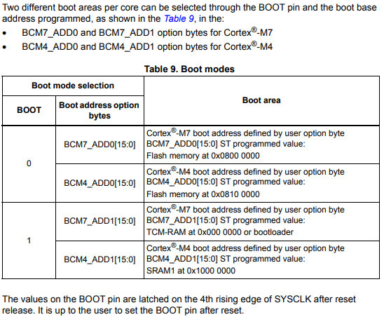

I am working on the boot process and security of the STM32H757.
For my tests, I have placed the two boot addresses for the two cores (ADD0 and ADD1 for CM7 and CM4) in the internal flash memory, with an ISR vector at each boot address :
ADD0: standard ISR vector calling the standard Reset_Handler, which in turn calls the main function
g_pfnVectors:
.word __initial_spTop /* Use internal RAM for stack for calling SystemInit. */
.word Reset_Handler
.word NMI_Handler
.word HardFault_Handler
.word MemManage_Handler
.word BusFault_Handler
.word UsageFault_Handler
and ADD1: virtually the same ISR vector but calling BootPin_Handler instead of Reset_Handler
g_bootPinVectors:
  .word  BootPin_Handler
  .word  NMI_Handler
Everything seems to be working properly, at least up until the security test.
When RDP is set to level 0 or 1, everything is fine and everything seems to work, but when I set the RDP level to 2, it no longer works; the programme still launches at ADD0.
I’ve tried to find a link between the two in the documentation, but either I can’t find it or I don’t understand it.
Can anyone help me?
To set level 2, I download the program in the device and then switch to level 1 then to level 2. In option byte I only changed boot address and RDP level. Maybe I have missed a step ?

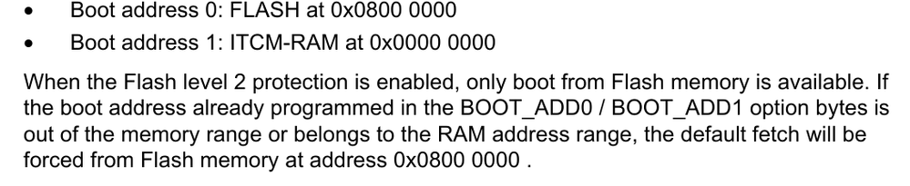

RDP2  closes the chip against any external access - irreversible.
...read in rm.
..from RM0433.

from rm:
Onizuka09
Hello @MA4
In RDP level 2, on boot for user flash is allowed so booting from System memory and RAM is disabled.
The Boot pin feature enables the selection of 2 boot areas :
1- you are using RDP level 2, setting BOOT_PIN = 1 is no more possible  ( CM7 boots to TCM-RAM or system bootloader and CM4 boots to SRAM1)  only BOOT_PIN = 0 is possible (boot to user flash  ).
2- When changing the default starting boot address in linker script, you should have also to update the option bytes (BCM7_ADD0 and BCM7_ADD0 ) with the new addresses, or you can setup in the linker script with the default boot address that is already set for both cores.
3- Even though, you set BOOT_ADD1 in the option bytes ( this points to RAM), in RDP level 2 this is considered invalid and the system will forcefully boot to the default address which is ADD0.
Please check RM0399 section 2.6 Boot Configuration for more information.

Jocelyn RICARD
Hello ,
Looking at RM0399 and other , I cannot find evidence that BOOT0 pin is no more used when RDP2 is enabled.
I think this is a missing information.
In fact, in all STM32 the BOOT0 pin is no more fetched in RDP Level 2.
The RDP2 can be seen as a boot lock feature, meaning you can only boot in address provided in ADD0.
The behaviour you see when enabling RDP Level 2 is expected.
I will ask internally to add this information to the reference manual.
Best regards
Jocelyn
