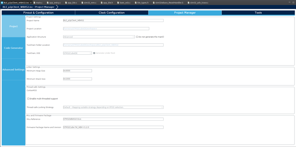

I have build the p2pClient project from the github you have sent me but the problem remains. I added the macro and the code line to start scanning. RSSI always returns 0.
Joe_
In the bottom of your screenshot, we can see that your project still uses v1.2.0.
But how can I use the 1.1.1? I used the .ioc file in the Github link that you provided and it still generates 1.2.0 version on the project.
Even if I delete the firmware files and replace them by version 1.1.1 the STM32CubeIDE automatically downloads the 1.2.0 version and replaces it, making it Impossible to use that version.
