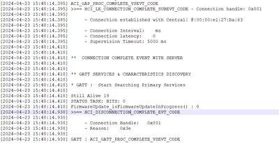

Hey,
I'm working on custom BLE Central and Peripheral project to make connection and send some sensor data over BLE. For this I'm referring to BLE p2pServer and p2pClient along with p2pRouter example projects. I'm able to make a connection with the server, but immediately I get HCI_DISCONNECTION_COMPLETE_EVT_CODE with the error code for reason as 0x3E. Can anyone help me out with this.?
Attaching the snapshot of the debug messages.

Hello @ABN
The error code 0x3e means "The Connection Failed to be Established / Synchronization Timeout error code". It indicates that the LL initiated a connection or initiated synchronization to periodic advertising but the connection has failed to be established or the Link Layer failed to synchronize with the periodic advertising within 6 periodic advertising events of the first attempt.
If you are experiencing this issue directly after connecting your STM32WB to a server, it could be due to interference or instability in the connection establishment process. It is recommended to check the environmental conditions and ensure that there are no sources of interference near the devices. Additionally, reviewing the configuration of the clock sources like LSE and HSE, as well as ensuring that there are no issues with GPIO toggling or flash access, might help in resolving the issue.

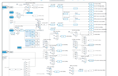

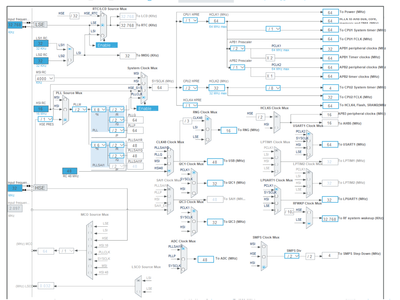

Hello @STTwo-32 ,
1. There are no sources of interference. Only central and peripheral devices are present.
2. Snapshot of the clock config of Central device.
3. Snapshot of clock config of Peripheral device.

2+3) I suggest you to add the following line of code to your central and Perpheral.
int main(void)
/* USER CODE BEGIN 1 */
HAL_PWR_EnableBkUpAccess();
while(HAL_IS_BIT_CLR(PWR->CR1, PWR_CR1_DBP));
__HAL_RCC_LSE_CONFIG(RCC_LSE_OFF);
__HAL_RCC_LSEDRIVE_CONFIG(RCC_LSEDRIVE_MEDIUMHIGH);
/* USER CODE END 1 */
