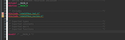

this is the thing I'm getting in the console when I tried it to run, I copied all the files in the source and inclusion file

Sorry, I was busy with personal work, I have never used HAL library and don't know how to use it, i have error on the inclusion file I've mentioned below... can you please give me some bare-metal code or with CMSIS?
#include "stm32f4xx_hal.h"
#include "stm32f4

fatal error: stm32f4xx.h: No such file or directory
> fatal error: stm32f4xx_hal.h: No such file or directory
Is it really so hard to troubleshoot this error? Does the file exist? Is it within the include paths?
If you're not using HAL, you shouldn't be including HAL files anywhere.
If you can't troubleshoot this, you may not be successful programming bare metal.
I'm saying that I don't even have those files and don't know where to get it,
as I have never used HAL, I asked for a bare-metal code or a code with CMSIS
I don't want to use HAL, They asked me to use HAL, as they said They don't have code other then the HAL library.
