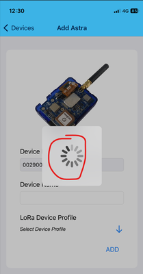

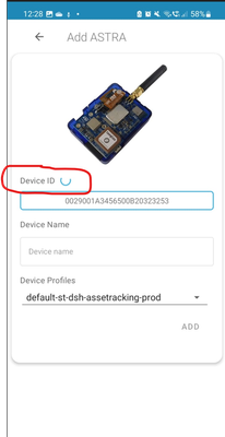

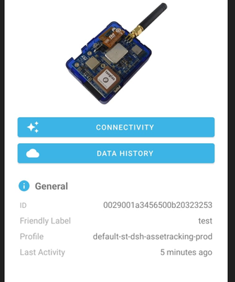

I´m doing my first try with the board STEVAL-ASTRA1B, try to run the example binary for Logistic.
LoRa can not join the network:

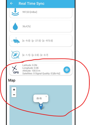

on the APP ST Asset Tracking there is no data from GPS:
some hints? Thanks in advanced.

For the GNSS data display problem, I suggest you to use your device outdoor because GNSS does not work well indoor.

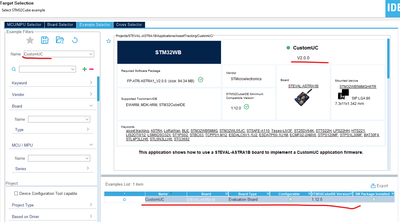

I suggest you to use the CustomUC application with the last version of CubeMX for your application.

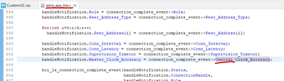

And now it has another problem, after I flash the user application CustomUC.hex;
the blue LED is permanent on, no bluetooth connection, no serial output.

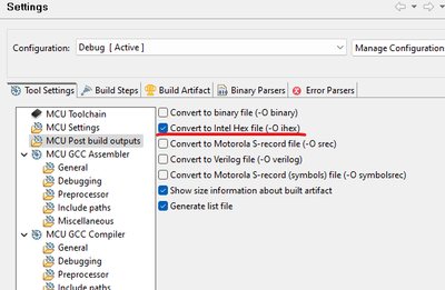

Sorry, I´m a newbie to ST development environment, as I understand CubeMX is for generating code and it is in CubeIDE integrated, so I just use CubeIDE and import the CustomUC project like this
with this setting I get a hex file
after flasing it in the board, nothing happens. No USB connection, No any LED blinking, it seems nothing is running.

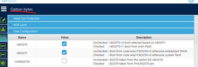

another question: I´m a little coufused about these three settings
how should they look like before and after flashing new Copro_wireless_binaries? should I change them manuallly if I flash another wireless stack, or the software handles them automatically?

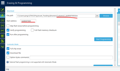

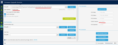

Hello again,
After doing a full chip erase
here is how I flash the wireless stack and the CustomUC binary, and the output.
everything seems successful, but nothing is running.

21:22:32 : Requesting Read FUS Info
21:22:32 : Warning: Option Byte: nSWboot0, value: 0x0, was not modified.
21:22:32 : Warning: Option Byte: nboot0, value: 0x1, was not modified.
21:22:32 : Warning: Option Byte: nboot1, value: 0x1, was not modified.
21:22:32 : Warning: Option Bytes are unchanged, Data won't be downloaded
21:22:32 : Time elapsed during option Bytes configuration: 00:00:00.000
21:22:32 : Succeeded to set nSWboot0=0 nboot1=1 nboot0=1
21:22:32 : Memory Programming ...
21:22:32 : Opening and parsing file: 0x495_FUS_Operator.bin
21:22:32 : File : 0x495_FUS_Operator.bin
21:22:32 : Size : 8.00 KB
21:22:32 : Address : 0x08000000
21:22:32 : Erasing memory corresponding to segment 0:
21:22:32 : Erasing internal memory sectors [0 1]
21:22:32 : Download in Progress:
21:22:32 : File download complete
21:22:32 : Time elapsed during download operation: 00:00:00.224
21:22:32 : Application is running, Please Hold on...
21:22:32 : Reconnecting...
21:22:32 : Reconnected !
21:22:33 : FUS_STATE_IDLE
21:22:33 : Read FUS state command execution finished
21:22:33 : Read FUS Info execution finished

21:23:11 : Memory Programming ...
21:23:11 : Opening and parsing file: CustomUC_0x08007000.bin
21:23:11 : File : CustomUC_0x08007000.bin
21:23:11 : Size : 277.34 KB
21:23:11 : Address : 0x08007000
21:23:11 : Erasing memory corresponding to segment 0:
21:23:11 : Erasing internal memory sectors [7 76]
21:23:12 : Download in Progress:
21:23:16 : File download complete
21:23:16 : Time elapsed during download operation: 00:00:05.657
21:23:16 : Verifying ...
21:23:16 : Read progress:
21:23:17 : Download verified successfully
21:23:17 : RUNNING Program ...
21:23:17 : Address: : 0x08007000
21:23:17 : Application is running, Please Hold on...
21:23:17 : Start operation achieved successfully
IIRHO.1
Hello again
I suggest you to:
  • Double-check that you are flashing the correct versions CustomUC binary.
  • Try resetting the device after flashing the firmware. Sometimes a reset is necessary to start the firmware running.
Best Regards.
Issam
Hello again,
this time I recompiled the CustomUC code by myself, there was an error in :
it was Master_Clock_Accuracy.
After I flash the device with new binary file, it seems working.
But the mobile app ST Asset tracking hangs, the device can not be added succecssfully.
I tried both android and ios version
Thanks and Best regards
