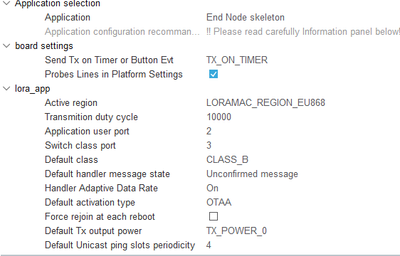

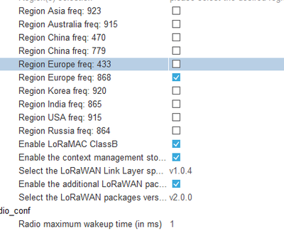

I am currently trying to run the end_node sample located on the STM32Cube_FW_WL_V1.3.1 package.  I would like to know if i can have some guideline on how to use LmHandlerDeviceTimeReq().
Which class do i need to use?
What lora server allows the time request?
How do i check if the MAC request is even sending?  Should I see this on the Logs under my application located on the server?
The request currently is not updating my system time.  The request is currently being done in a callback after a successful join.

My setup is as follows:
