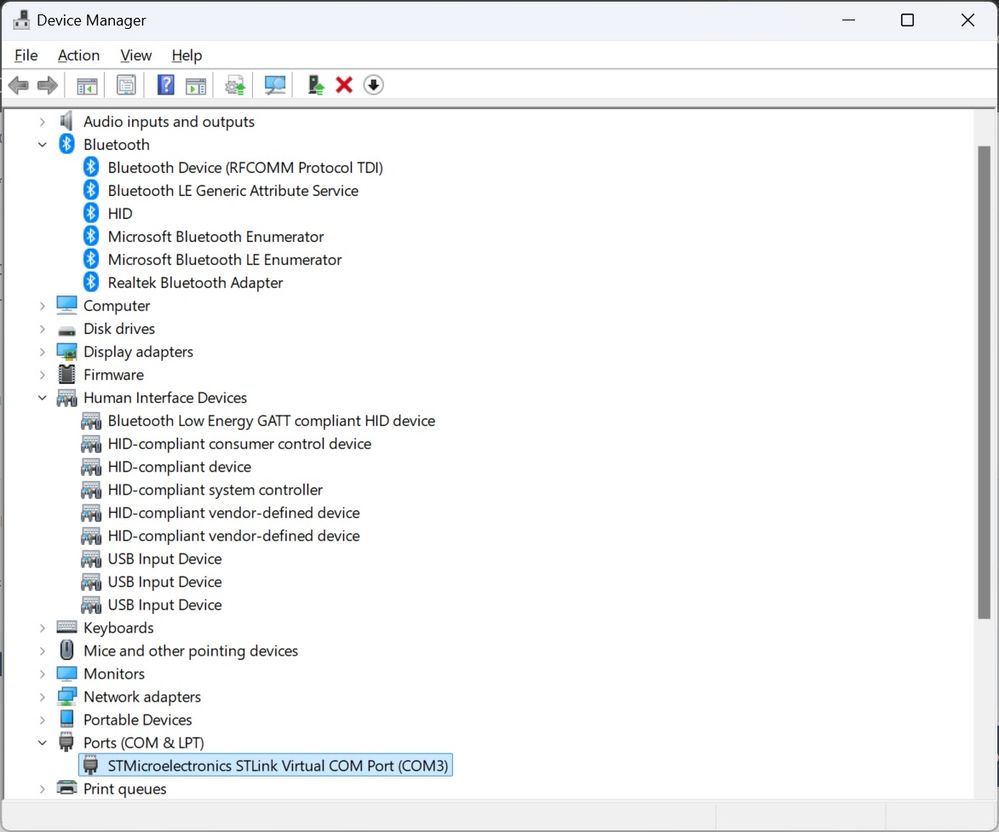

After connecting NUCLEO-WB55RG with BLE_HID example - no action from pressing SW1.

Why something should happens on a terminal window connected to COM3 STLink ?

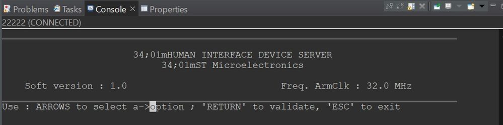

Hello @GS2
When clicking on the SW1 Button, you will see this on the Serial monitor:
Best Regards.

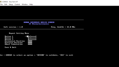

So now I have 3 questions:
1. is it possible to change PIN code from "111111" ?
2. Why something should happens on a terminal window connected to COM3 STLink ?
3. After pressing SW1 - I have the follow:
STTwo-32
July 15, 2024
  1. Yes you can change the "111111".
  2. We have programmed the project to do that.
  3. Yes it should be that.
