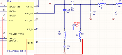

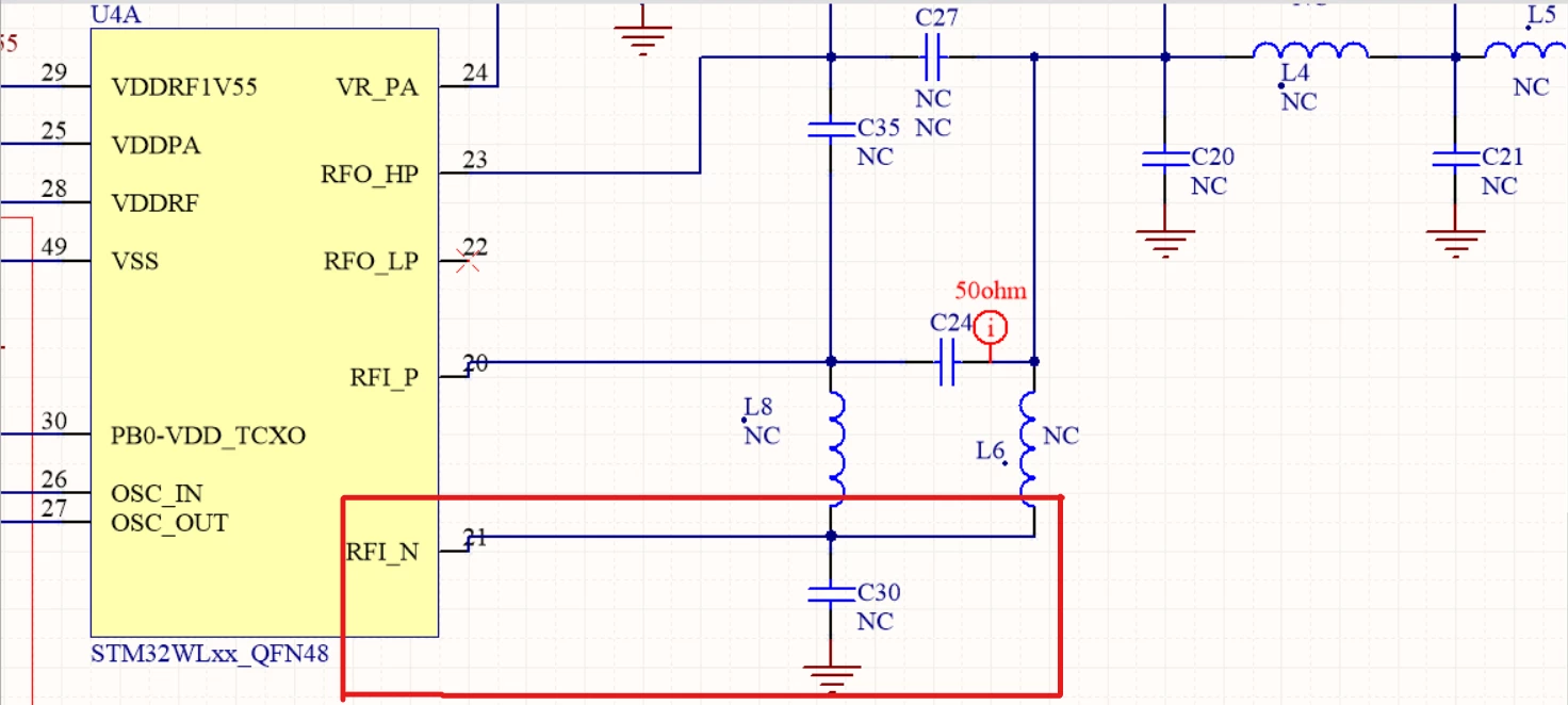

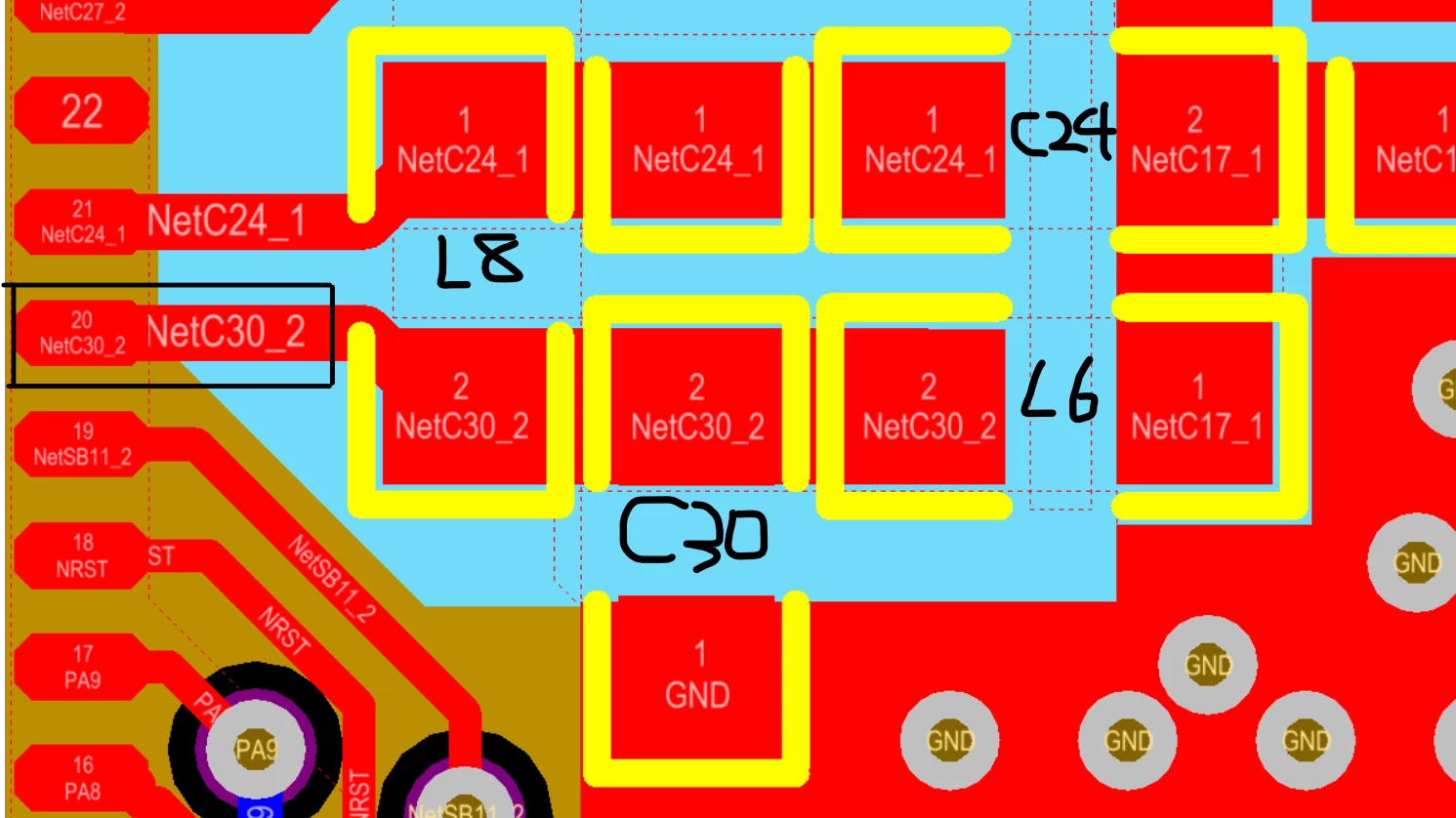

Recently, I studied STM32WL series and want to design board by myself, so I reference MB1789-HP files to design. I have some questions about sch and pcb files, I know MCU pin 21 (RFI_N) is connect to C30 capacitor, but in PCB file, MCU pin 20 and pin 21 connect components doesn't match to sch. Whitch one is correct ?

Hello @CY_Tsai ,
Thank you for bringing up this issue, I reported this issue internally ( Internal Ticket number: 165876)
I suspect this issue is related to an update of one of the concerned documents.
I will keep you updated!
Sarra

Sarra.S
Hello again @CY_Tsai
Please find attached the updated schematic aligned with the PCB.
Hi @Sarra.S
I got the file, but I have a question confused me, I compare others demo board files, such as MB1720, MB1791, MB1792, MB1842. Their schematic and PCB file are macth to each other, and they don't need to change MCU PIN20(RFI_P) and PIN21(RFI_N) to connect balun equivalent circuit. Why is there such a different?
