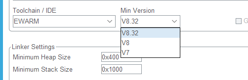

In the latest STM32CubeMX (6.4.0), EWARM Toolchain can only be selected up to V8.32.
So I think the output source code will not work with EWARM v9.xx.x.
Has anyone ever created firmware with STM32CubeMX (6.4.0) and EWARM v9.xx.x?
