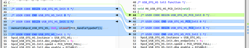

However I found problem with the following in the earlier created example code (without initial changes by MX):
  • I opened .ioc file and added TIM16 and all LEDs (which were previously added manually in the code).
  • Generated new code with MX and opened it in Cube
  • Removed my previous manual additions (TIM16, LDEs) which are generated by MX now
  • Compiled and flashed the code - it crashed
Start doing diff - a lot of system file changes (for example, CMSIS version changed from 1.10.5 to 1.10.7)
The only important change in app code I found was missing memset() line in usb_otg.c:
  /* USER CODE BEGIN USB_OTG_HS_Init 1 */
  memset(&hpcd_USB_OTG_HS, 0x0, sizeof(PCD_HandleTypeDef));
  /* USER CODE END USB_OTG_HS_Init 1 */
See diff of the old and new:
Even it was between user input comments it was gone. Possibly due to change in comment styles...
I assume the change of the text after "USER CODE BEGIN" is the reason MX generated code failed if there was something in between lines. Hope this clarification helps.

What you observed is can be consistent with regenerating an older example with a newer CubeMX version. In such cases, the generated code structure can change, and some user code sections may not be preserved exactly as in the original example.
That is why we need to check whether this is a CubeMX issue or whether some required user code is missing.
