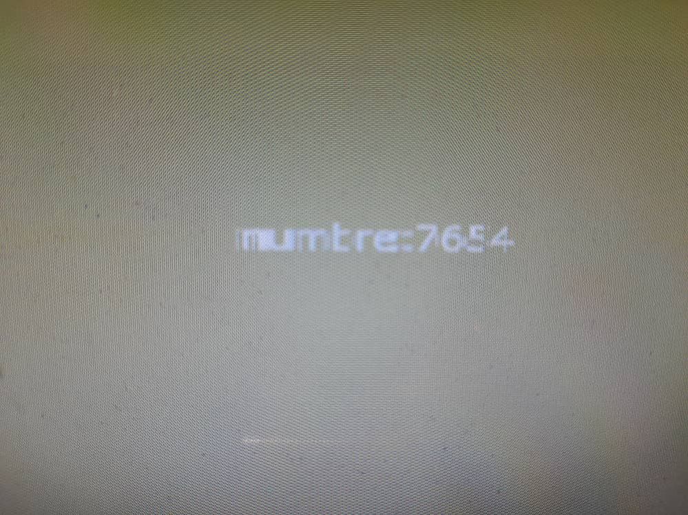

Hi
I use touch gfx wildcard to show characters and variables in the text area but the characters are shown like the attached photo... I configured the MPU as follows but still does not work.
I would appreciate any help. I will upload the LCD photo and MPU codes.
PS:I use stm32f767ig
SDRAM
Qspi
fonts and texts are in IROM.

N. SANTINI
From this screenshot it looks like you have a cache issue.
Where is your frame buffer located ?
If it is in external SDRAM (0xC0000000) then I would suggest to set the region as MPU_ACCESS_SHAREABLE.
This indicates that several masters can access it (here LTDC and DMA2D) and that cache must be disabled to guarantee data coherency.
