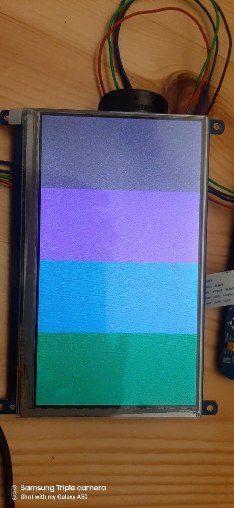

Hai....,
I am using STM32F746IG custom board and 7Inch Display STM32CubeIDE1.6.0 and TouchGFX4.16.0
After upload the code Display show four colors see bellow.

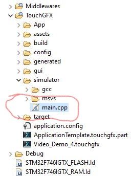

In project ..../TouchGFX/simulator/main.cpp show hide and cross symbol image attached bellow for your reference.
any one have idea about this problem.......? Please...

I would suggest to edit the tag section of your post to increase its visibility, this is not really a TouchGFX question.
For my understanding does this create a compilation error ? This main is used by the simulator of TouchGFX Designer.
/Romain
