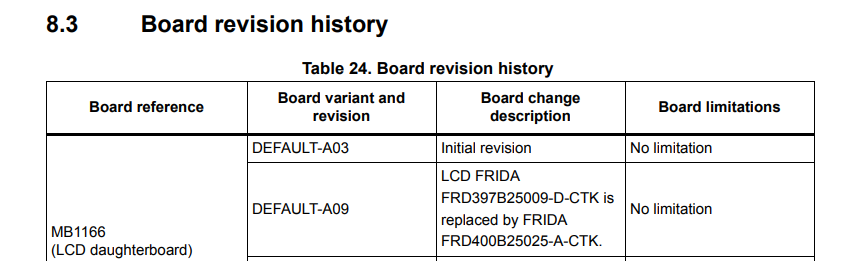

Osman SOYKURT
Hello SKuma.49,
I can see on the image you shared, you are using revision AT2 with a MB1166-A09 LCD daughterboard.
I tested on my side with a revision AT1 with a MB1166-A03 LCD daughterboard and I didn't face the issue you're mentioning.
From what I can see on the user manual of the STM32H747i-disco, the display changed between these 2 revisions (LCD FRIDA FRD397B25009-D-CTK is replaced by FRIDA FRD400B25025-A-CTK)
I think that could be the issue, but more investigation is needed.

Hello SKuma.49,
As reported by S.Ma and explained into the corresponding user manual, a boards product is identified using two stickers: the product identification one and a board reference one for each board composing the product.
According to the shared pictures, your product identification is DK32H747I$AT2. This product (DK32H747I$AT2) is based on a new LCD display FRIDA FRD400B25025-A-CTK which is not compatible with the released Demo firmware. This explains why this product is not delivered with the Demo firmware already flashed.
If you are using the released demo firmware, it won't work properly with this product. For this product, it is required to use the updated LCD display driver available on GitHub and to recompile the demo firmware.
