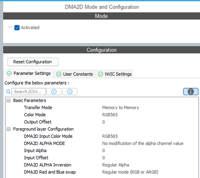

It was recently recommended to me that I enable DMA2D on my project to possibly alleviate another problem that I'm having detailed here (Weird horizontal artifacts in touchGFX buttons - STMicroelectronics Community). My question is, how do I properly set it up? I've read several documents on the DMA2D including How to use Chrom-ART Accelerator to refresh an LCD-TFT display on STM32 MCUs - Application note and 8. Hardware acceleration | TouchGFX Documentation but I'm left scratching my head.
If I simple enable DMA2D in MX with my current project without making any code changes like this :

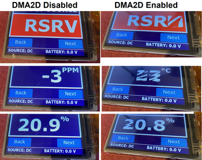

Then I get weird distortions on some of my text:

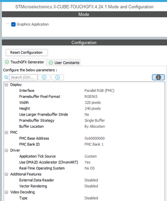

Two additional observations:
1. The character distortion appears to go away when I shrink the font down to about 60 (currently its at 80)
2. If I set the option 'Use DMA2D Accelerator (Chrom-Art)' within the touchGFX settings in MX to 'No' but leave everything else the same (including leaving DMA2D enabled), the problem also goes away, though I suppose this is not surprising.
