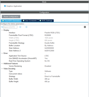

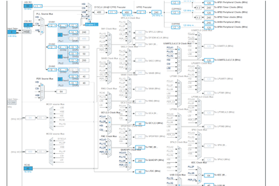

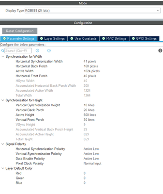

Pixel clock 48MHz, let me explain better, I don't make the switch from landscape to portrait, the project is directly in portrait.
In the previous videos I show that if I invert "only on touchgfx gui" the orientation from portrait (my project default) to landscape (without changing anything), the pixeling effect does not occur.
I use a double buffer, but even changing to single I get the same effects, even changing the pixel clock I get no results, still the same effect.
SDRAM used 256Mb, font, picture and text on qspi.

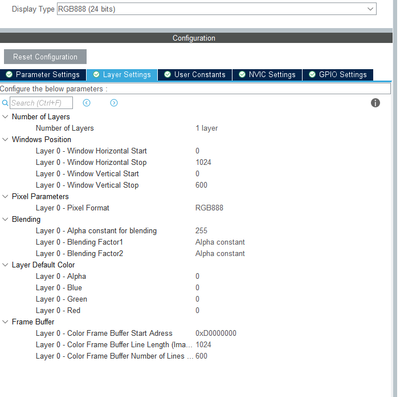

Below are some photos of the setup on cubemx.
Really thanks for the reply.
1024x600 is in RGB888 high bus intensive, read LTDC appnote pdf . You dont show MCU used, then if your app isnt colorfull change to RGB565 is simple choice. One more Q is your SDRAM 32bit?
Thanks for your help. The MCU is STM32H743, the SDRAM: IS42S32800G, 32Bit, by QSPI I mean the external flash. I forget to say about the display, it is a LVDS display and I use DS90CR285 for conversion. This display accept RGB888 or RGB666. But the strange is the difference of horizontal to vertical differences.
an4861-introduction-to-lcdtft-display-controller-ltdc-on-stm32-mcus-stmicroelectronics.pdf chapter 5.6 , Table 12 etc.
And isnt relevant what display RGB accept, but how framebuffer type LTDC handle.
