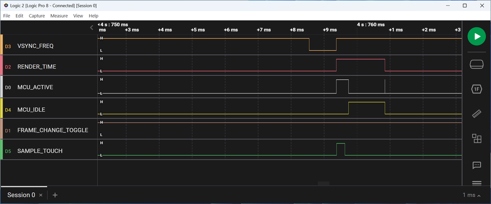

‎2024-02-16 9:08 AM - edited ‎2024-02-16 9:54 AM
I have a similar question and I didn't find the provided answer to my satisfaction. I'm using the STM32H735G-DK development board and I have modified the project to work without FreeRTOS (I've attached my oswrappers). It works, but I noticed only MCU_ACTIVE is NOT set by TouchGFX. If I set it while backPorchExited is being called, then MCU_ACTIVE behaves exactly the same as RENDER_TIME. If I check the documentation I see something different:
https://support.touchgfx.com/docs/development/touchgfx-hal-development/scenarios/scenarios-measure-performance#performance-metrics
MCU_ACTIVE can become low during parts of the RENDER_TIME in this example.
I use isVSyncAvailable() and when false I run my own code in the loop. Only when isVSyncAvailable is true I call backPorchExited (during which I set MCU_ACTIVE). Higher priority "tasks" are run in a timer interrupt (and they quickly finish in a few cycles) or peripheral interrupt.
taskYield and taskDelay are not called. But I did notice that if I push a button takeFrameBufferSemaphore is waiting for a semaphore to be available. If I clear MCU_ACTIVE there and call my own idle function I get the same pattern as in the example (I also added an MCU_IDLE signal during this waiting time). However I still wonder why this is happening inside the library.
So my questions are:
- why is it waiting for the buffer to be available again? Is it copying graphics using a DMA? Is it waiting for some type of interrupt? Obviously it's waiting for something without using the MCU core.
- when is the LTDC writing to the display? Is this during the high or the low part of the VSYNC_FREQ?
- I noticed the following article talks about hooks that are available at different stages of rendering. I didn't find those anywhere. Where can I get access to these hooks? https://support.touchgfx.com/docs/development/touchgfx-hal-development/touchgfx-al-development-introduction
