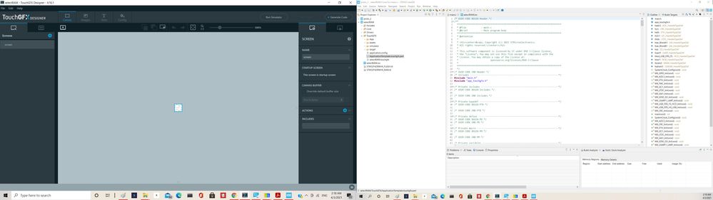

when i start the designer from stm32CubeIDE, the canvas is very small in size,

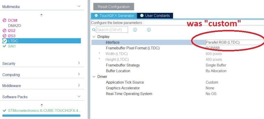

I figured out the problem. It was the Display Interface mistakenly left at "custom" instead of "Parallel RGB (LTDC)". I apologize for any inconvenience. Thank you.

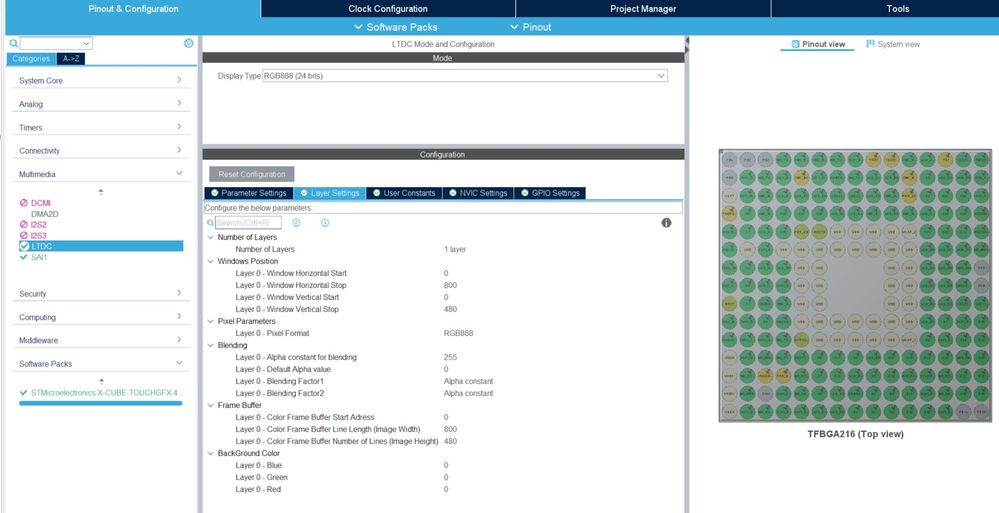

Follow up on my question, please note the LTDC config screen:
