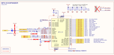

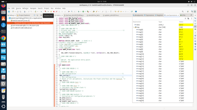

I have i2c slave model work properly the default adress used by contoller given in schematich work on 84 aand 85 adress but the other peripheral adress not get give me the roadmap for the coding of communication protocols
I2C Slave Address detect. how can i code done for other peripherals using mfx expander give me solution
