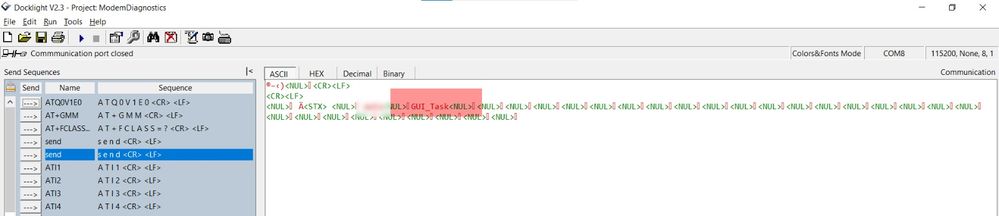

I am trying to capture UART message once a button is pressed. I have implemented the functions to do that and while debugging i see the steps required to do that.
However, when the UART communication happen, i get strange messages (check photo)
Note: i am not using a Queue nor a separate to do the UART comm. However, you can see a GUI_Task mentioned in the UART message (that is the main task and this is not used within the code)

I bet it's a stack overflow. When I was first starting with FreeRTOS and TouchGFX i would wonder why some of my arrays would sometimes get populated with the words "TouchGFX_Task", among other garbage. Try increasing the task stack size in CubeMX.

No, I think the issue is a some sort of overflow. Somehow you are trying to read or write outside of the bounds of your arrays and into the section where FreeRTOS stores it's stack information (edit: or where your program stores other strings)
HAL_UART_Transmit(&huart2, (uint8_t *) "mata", 28, 1);
Just noticed this. Dangerous! Is it even defined behavior to cast a string literal as uint8_t*? Even if you can, your string is 5 characters (m, a, t, a, \0) and you telling the function send 28. No wonder you are reading strange information.
Edit: did a bit more digging and yes, that behavior is defined but absolutely having 28 in the length field is the reason you are having that issue. The UART functions don't care about null terminators!

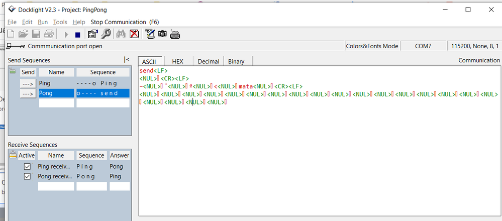

Thanks for the input. I added the value of the sent buffer to check Still why pData (as "send") that is structured with sizeof() is not showing up?
Is the if statement even being entered? Is xx ever == 0? Why do you run xx++ only to set it to zero at the end of the snippet? It makes no sense in the context of the code you've provided. Step through it with a debugger and make sure your program flow is as you intend.
Embedded UI/UX Consulting: cadenza.design
Well, the same code works ok when not using touchgfx + freertos (as intended).
This is the uart channel . You can see the send message, but no response from the receptor.
A lot of NUL flags. What's wrong?
