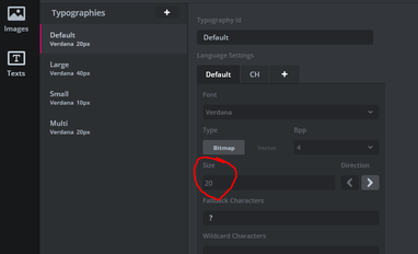

Do you think, that some of these font properties (or at least font height based on user selected size) could be shown in Gfx Designer dynamically, before running font code generator ?
Reason I am asking is realisation that, even though I set the same 'Text:Typography:font size' for 2 fonts (which sets font's baseline), the font heights differ - font_1.getHeight () is 25px and font_2.getHeight () is 26px.
font_1;  size(or baseline) 20px, height 25px
touchgfx::GeneratedFont& getFont_verdana_20_4bpp()
    static touchgfx::GeneratedFont verdana_20_4bpp
		glyphs_verdana_20_4bpp,        * @param  glyphs
		512,                           * @param  numGlyphs
		25,                            * @param  height
		20,                            * @param  baseline
		0,                             * @param  pixAboveTop
    return verdana_20_4bpp;
font_2;  size(or baseline) 20px, height 26px
touchgfx::GeneratedFont& getFont_NotoSC_20_4bpp()
    static touchgfx::GeneratedFont NotoSC_20_4bpp
		glyphs_NotoSC_20_4bpp,          * @param  glyphs
		375,                            * @param  numGlyphs
		26,                             * @param  height
		2,                              * @param  pixAboveTop
    return NotoSC_20_4bpp;

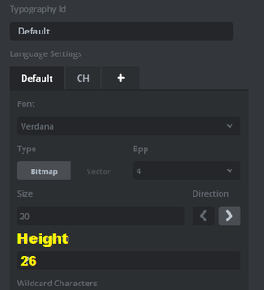

Therefore, the font's height would be a valuable information while setting font size/baseline. Before running font code generator and having to check laboriously resulting "touchgfx/generated/fonts/src/Table_<typography>.cpp". Something like this:
What do you think ?
