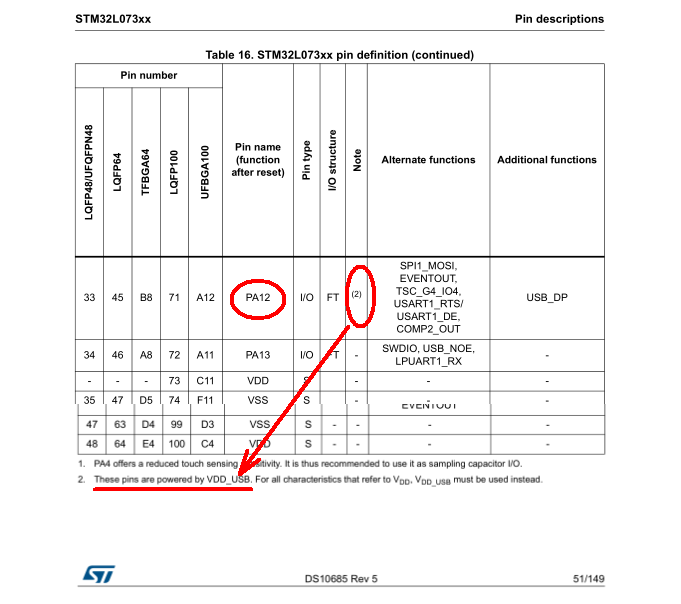

What could make a specific GPIO (PA12 and PA11) on STM32L073V8T6 work when configured as an Input but not work when configured as output?
oolor.1
I have a static LCD, a couple of other GPIOs configured as output and SWD which are all working fine. PA12 does not work when I configure it in output mode and i toggle the pin. I have tried using PA11 also with no success. The .ioc file of my project is attached. Thanks.
Do you do this in debugger? Read out and post all GPIOA registers.
Do you observe *directly* on the pin, e.g. using oscilloscope probe touching the pin?
What is connected to that pin, physically? Is this some kind of a "known good" board such as Nucleo or Disco (in which case make sure you removed all jumpers and solder bridges associated with this pin), or your board?

Thanks. I'm trying to develop a product with the chip... so it is on my PCB design. The pin is connected to an NPN transistor meant to control an active buzzer. I have removed this transistor so I can run a direct check on the GPIO.
I observed the pin directly with an oscilloscope.
Theses are the readings on the GPIOA registers:
When low:
MODER: 0xA9EAACAB
OTYPER: 0x0
OSPEEDR:0xC000000
PUPDR: 0x24000000
IDR: 0x6000

waclawek.jan
This was the cause of the problem because on my board VDD_USB was floating because I thought it powered only the USB. :see_no_evil_monkey:
Thanks so much.
