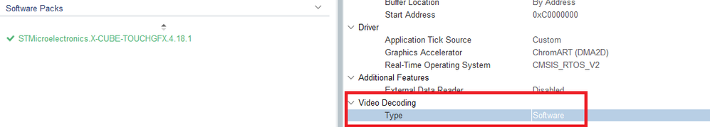

Have you enabled Video Decoding in the TouchGFX Generator settings in STM32CubeMX ? This step is necessary to work with the video widget. Here is a link to the Video Decoding article in the documentation, and a link to the article on how to work with video in TouchGFX.

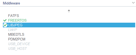

In CubeMx generator you need to:
1- Activate LIBJPEG in Middleware menu.
0693W00000HrVm0QAF.png2- Activate Video feature in Software mode from Software Packs menu:
0693W00000HrVmAQAV.png 3- Re-generate the code
I'll just chip in to warn that there are more settings required within LIBJPEG and the Video Decoding section to be able to work with the video widget as stated in the documentation links I shared.
