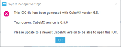

Wired or anyone else,
I've been testing a number of the options in this forum to try solve my identical issue. I too unfortunately updated past CubeMX 6.5.0 to 6.8.1. I tried to reinstall the CubeMX 6.5.0 version to align with your suggestions but am now getting this error that the project was generated with 6.8.1:
Is there a way to downgrade the required CubeMX .ioc file so it works with 6.5.0 to testing building with that?
Thanks!
