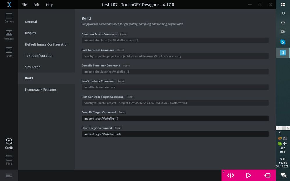

‎2021-10-31 1:49 AM
After install Designer on your desktop is two shotcuts. One Designer and second command promt envi setup for make.
And here is lines for make : usable directly from GUI...
when you use command line envi , make need run in right folder as you can see on image.
‎2021-10-31 5:53 AM
Ok, so I guess I'm still confused here. Isn't the command listed under "Compile Target Command" what I used in my example above? Looking at the TouchGFX Environment, it looks like the primary difference is that their make is version 4.1 while mine is 4.2.1 and their gcc is 7.3.1 20180622 and mine is 10.3.1 20210621. Do I just need to get older versions of the tools to make this work? Otherwise, what is the difference between the environment and my PC? To note: I haven't actually tried to build anything from the environment, since I can't really find a good tutorial on how to actually use it. Opening it from it's location on my system, there's no way to point it to my application to build, and I don't really see any option to give it a location when running.
When I do get that figured out, why would the environment make/gcc toolchain work where mine didn't? Won't the make command just give me the same error that mine did? I'd like to actually understand the issue here, if possible to understand what I can do better in the future.
‎2021-10-31 6:17 AM
TouchGFX MinGW development environment version 4.17.0 for windows
Refer to local windows drives using the following notation: '/<drive-letter>/'.
To navigate to folder e.g. c:\projects type:
cd /c/projects
To compile and run a TouchGFX example, navigate to application folder.
Compile the simulator:
make -f simulator/gcc/Makefile -j6
Finally, run the simulator:
./build/bin/simulator.exe
marian@PC25 ~
$ cd /c/TouchGFXProjects/testik07/TouchGFX
marian@PC25 /c/TouchGFXProjects/testik07/TouchGFX
$ make -f ../gcc/Makefile -j8
Reading TouchGFX/application.config
Linking TouchGFX/build/bin/target.elf
Producing additional output formats...
target.hex - Combined internal+external hex
intflash.elf - Internal flash, elf debug
intflash.hex - Internal flash, hex
extflash.bin - External flash, binary
maybe yout toolchain work too, simply cd as instruction say...
