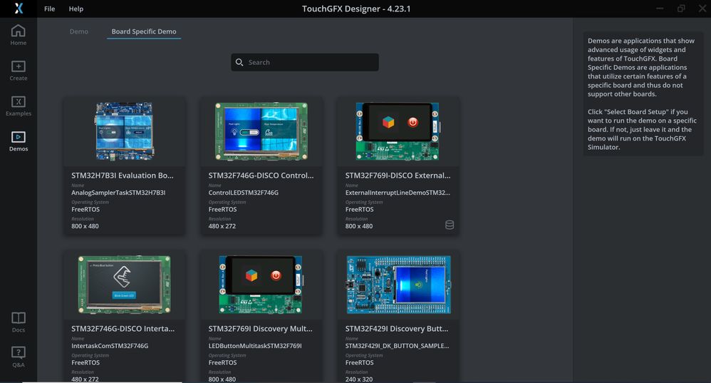

I totally understand the difficulty, but I think you can add a button controller without changing TouchGFXConfiguration. There are a number of examples that indicate how to work with external buttons. You can find them under Demos -> Board Specific Demo tab.Board Specific Demos
You can just use one of them as inspiration for your development, especially STM32F769I-DISCO External Interrupt Line Demo can be a great help.
You can have your code for the Button, and then add them to TouchGFX from TouchGFXHAL.cpp, initialize() instead of TouchGFXConfiguration (By using setButtonController function).
