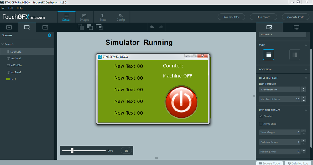

I am working on below setup:
Software Tool Chain:
STM32CubeMX 5.6.0
TouchGFX 4.13.0 Designer
STM32CubeIDE 1.3.0
STM32F746G Discovery Kit v3.0.1 (AT)
Hardware:
STM32F746G-DISCO (Discovery Board)
USB Mass Storage Drive (32 GB)
I have worked on LED, BUTTON , ADC, External Interrupts, UART with TouchGFX Buttons and TextArea Wildcard.
Now, I have to send USB Files Names to Scroll List Elements.
For Simplicity As for now , I have created in 2D Array and Send One by one with FreeRTOS Queue .
char TxBuffer[5][MaxElementsPerQueue]= {"LIST", "HELLO", "TouchGFX", "STM32F7", "SCROLL"};
if(pdTRUE == xQueueSend(USBTxTaskHandle,TxBuffer[i],(TickType_t)100 ) )
Same ways receiving in Model.c
void Model::tick()
		if(pdTRUE == xQueueReceive(USBRxTaskHandle,RxBuffer[i],(TickType_t)100
void Model::USBRx(char temp_RxBuffer[] )
	modelListener-> USBRx(temp_RxBuffer);
But Getting Error .. As below :
void Screen1Presenter::USBRx(char temp_RxBuffer[] )
	// view.USBRx(temp_RxBuffer) ;  // Error
	  touchgfx_printf("View \n");
Is it right way ? Is there any application note or example for that .. ?

Hi @Community member​ ,
Are you trying to ask how to update the list with, say a text string ?
If so, then you need to look into the API of the ScrollList. Your list consists of a custom container that has string elements. Try to set these string elements using the ScrollList object your code has created - I feel this should work.

 @Jagdish Bisawa (Community Member) Thanks for update..
Yes , I want to Update "NEW TEXT 00" with
ln Screen1ViewBase.cpp .
void Screen1ViewBase::buttonCallbackHandler(const touchgfx::AbstractButton& src)
    if (&src == &ledCtrlBtn)
        //Interaction1
        //When ledCtrlBtn clicked call virtual function
        //Call updateLEDState
        updateLEDState();
void Screen1ViewBase::updateItemCallbackHandler(touchgfx::DrawableListItemsInterface* items, int16_t containerIndex, int16_t itemIndex)
    if (items == &scrollList1ListItems)
        touchgfx::Drawable* d = items->getDrawable(containerIndex);
        MenuElement* cc = (MenuElement*)d;
        scrollList1UpdateItem(*cc, itemIndex);
ln Screen1ViewBase.hpp .
    virtual void scrollList1UpdateItem(MenuElement& item, int16_t itemIndex)
        // Override and implement this function in Screen1
I think I have to use concrete version of scrollList1UpdateItem in Screen1View.cpp.
void Screen1View::USBRx(char temp_RxBuffer[] )
   // How to Update Here..
  // scrollList1UpdateItem(MenuElement& item, int16_t itemIndex) ??
But could not find how to use here in
https://support.touchgfx.com/docs/api/classes/classtouchgfx_1_1_scroll_list
Am I right ? or any there API .
Thanks again ..

I am able to update "number" as per below tutorial
https://support.touchgfx.com/docs/development/ui-development/ui-components/containers/scroll-list
But still unable to update array .Also could not find any tutorials for that...
Please update if anybody have some idea.
