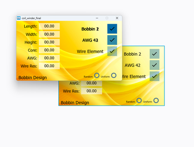

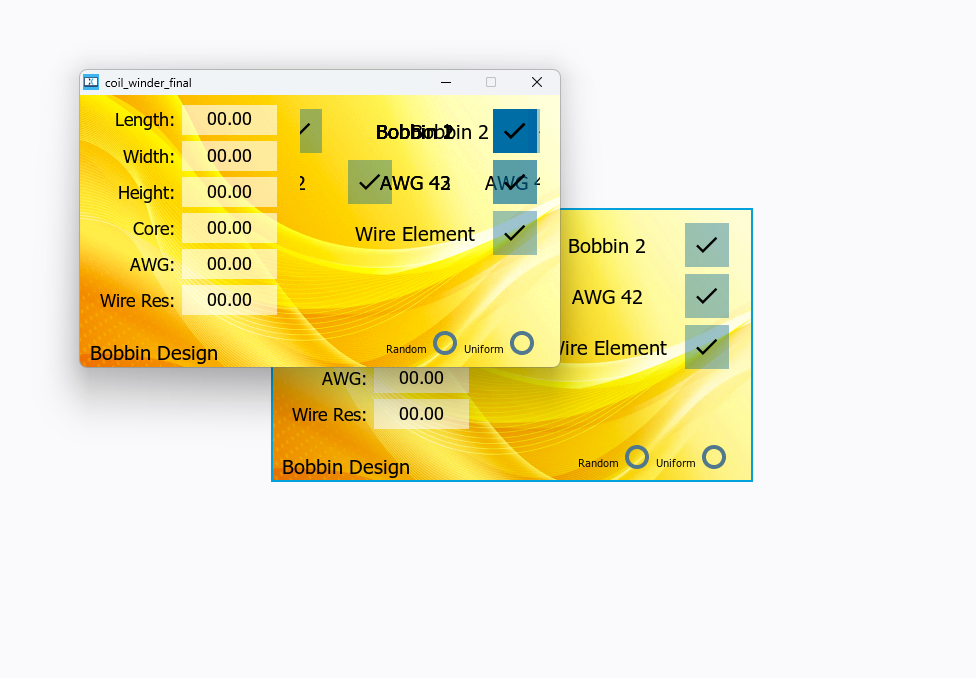

    Callback<mainView, wire_element_container&> wireElementClickedCallback;If the above code is commented out, the 'awgElements' and 'coilElements' lists scroll as expected when run in the simulator.  Uncommenting the code results in what appears to be a duplicate list, superimposed over the top.
(top two lists are partially scrolled for the purpose of illustration).
It would seem to be an issue with my implementation of the list arrays however, I have checked and re-checked the syntax against a working example of the code but I can not find the root cause of this. I'm clearly missing something. A pointer in the right direction would be appreciated. Thanks.

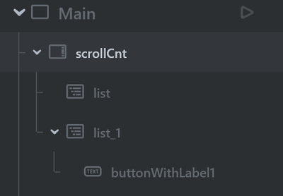

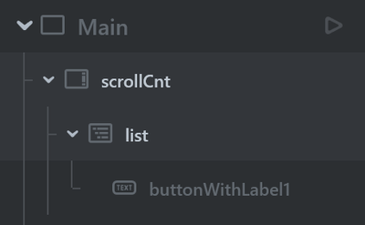

You dont show designer structure for container and list, but i mean you miss your idea add more lists into one scroll container. This cn work only if you calculate and change Y for all next list after render previous, not very usable.
Normal way is add containers into one list, then cahnge all lines in for with .add to one primary list....
This dont work
this yes
This dont work
this yes

@MM..1 You are correct. It has taken a lot of time to realize it, but I definitely over-complicated the use of containers and container types. I have since stripped the design back to it's basics and rebuilt it the very same way as you have suggested in your reply.
I think my fundamental mistake was using a Scroll List inside a Scrollable Container. I should have used a List Layout inside the Scrollable Container instead. I believe the UI will work as expected with these changes. Thanks for helping me out.
