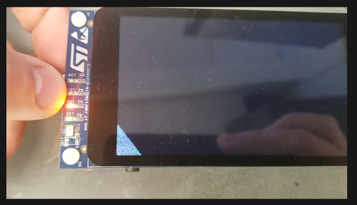

I couldn't figure out what was the cause but I started new projects and it seemed to work fine. I don't know if the issue was related to a bad configuration on that project or something else. I was using the visual studio to build the simulator when I was changing the code but not the ui and on the new project I just used cube ide and tested on the boards without touching visual studio. So It is working on the new project. An issue I have is when the graphics start a black and white dotted triangle appears on bottom left of the screen and I am not sure why. It seems like a minor software issue or something to do with a faulty screen. For evaluation it is not the end of the world.

‎2020-05-04 9:45 AM
Hello Martin,
You may find the picture of the issue attached above.
The issue happens for couple hundred milliseconds on startup.
