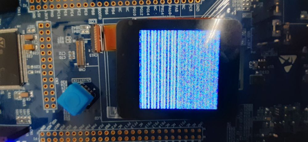

Good morning,
I bought an stm32f412g-disco board but it's impossible to program the screen with a TOUCHGFX application.
I'm using TOUCHGFX Designer 4.23 and stm32cubef4-v1-28
I created a project directly from TOUCHGFX Designer for the F412G-disco board.
But my screen remains blurred (see photo)
Is there a modification to be made in the configuration (.ioc)
THANKS

Hello @PhilZalkin ,
Yes, I can confirm the problem. Sorry for the inconvenience. We will fix the board setup as soon as possible

Any update on this one?
I got stuck with the same effect. Non of the examples are working form me.
TouchGfx newly created project do not displays properly.
2024-02-23 10:49 PM
Check if this work for your board STM32CubeF4/Projects/STM32F412G-Discovery/Examples/BSP at master · STMicroelectronics/STM32CubeF4 · GitHub
and after this work try add and customize TouchGFX normal way step by step.
2024-02-24 1:38 AM
This one compiles and works not every example, but it's something.
Now, I did learn already that my board is rev D, thus I have different touch controller, ft3x67 instead of ft6x06.
Given that I've added a flag `USE_STM32412G_DISCOVERY_REVD` this enables touch sensor test that's a progress :grinning_face:.
When it comes to TouchFX project, I've also notice that it uses ft6x06... after changing the generated code to use ft3x67 I finally get proper contents on a screen. :smiling_face_with_heart_eyes:
