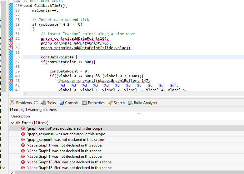

Hi, I would like that use a callback of timer (programmed with 10ms) to override the "ScreenView::handleTickEvent()" function, because this function has interrupt in ~14ms.

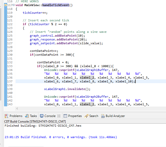

I managed to create the function and link the cpp and C files, but I couldn't use C++ functions (about graph..) in the timer callback that I created, there is an error like "was not declared in this scope" in which when I use it in the "handleTickEvent" function there is no error. Why is this happening?
Here is the .c file:

 //here dont works
void CallbackTim5(){
	msCounter++;
	// Insert each second tick
	if (msCounter % 2 == 0)
		// Insert "random" points along a sine wave
		graph_control.addDataPoint(10);
		graph_response.addDataPoint(20);
		graph_setpoint.addDataPoint(slide_value);

//here works
void MainView::handleTickEvent()
//    tickCounter++;

 Error:
Without Error:

How display config you use _? LTDC ? TickEvent is based on refresh rate on LCD for example 60Hz ... around 16ms , then when your display support and you need 10ms setup it to 100Hz frame refresh...

you cannot access a member of MainView like graph_control from a c function.
your callback must be a member of your view if you want to use this concept
