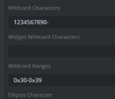

2024-07-04 11:10 PM
Font characters is added in code automatic only for static texts. When you manage wildcards in code, you need add chars manualy in designer font manager.
2024-07-04 11:15 PM - edited 2024-07-04 11:21 PM
I would appreciate it if you could explain it in more detail.
I'm not good at it yet so I don't understand what you explained.
The text was set as follows.
The numbers are set as follows.

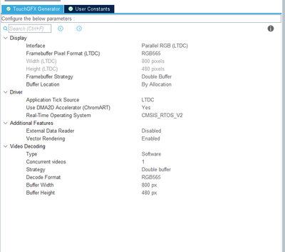

Hello @jschoi ,
Could you please share more information on the MCU you are using, the framebuffer strategy, and the place where you store your text and font (internal flash or external flash)?
Are you using the same Typographies for both the numbers and "Feedrate"?
Could you please set the Fallback Characters to "?" to ensure the issue is not from the characters being unrecognized?
looking forward to hearing from you
2024-07-05 02:14 AM
hello,
Thank you for your reply
stm mcu: stm32f746
Text and fonts are stored in external flash memory.
Numbers and feedrate do not use the same Typographies.
I captured the settings in the photo above. Please take a look.
And I entered "?", but "?" does not appear on the display. The same symptoms as the screen captured above still appear.

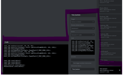

2024-07-05 03:33 AM
Thanks for the information.
Let's do a simple test. Please create a button that by clicking on it, text areas are invalidated by using textArea.invalidate().
And also try invalidating the whole screen by just calling invalidate();
If the texts appeared correctly after the button has been pressed, it indicates the problem is most likely with the GUI; otherwise, you need to ensure that your external flash works correctly.

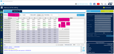

2024-07-07 05:47 PM - edited 2024-07-07 06:49 PM
Thank you so much for your reply
I tried the solution you gave, but
It wasn't resolved
In the photo below, I created a button and tried text.invalidate(), but the symptom is the same.
Also, I checked the external flash. Can you check if I checked it correctly?
I checked the external flash address where the text is stored and read the external flash memory, and the value was entered normally. Is this correct?
Since TextFlashSection and FontFlashSection memories are allocated from external to internal flash memory, they appear to work correctly.
If the external flash memory is faulty, shouldn't the image file be faulty as well? I don't understand why only the text image is displayed incorrectly. What is the cause?

2024-07-09 07:39 AM
The external flash data seems alright.
Unfortunately, I cannot detect where the issue stems from. However, I suggest starting an extremely simple project, like one just displaying a fixed text without any other elements, and slowly building upon that to make it more sophisticated. Especially, by adding wildcards and texts that are changed at runtime.
This way, it would be way easier to check the framebuffer to find out where the issue pops up.
