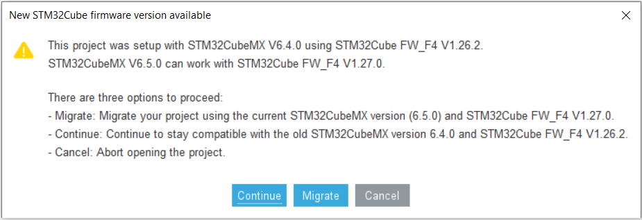

Solution: Update CubeMX to 6.5.
Remark: With Designer 4.19.1 and CubeMX 6.5 the function does not vanish anymore, but the designer seems to generate CubeMX 6.4 projects: When I open the ioc-file, I have to decide whether to continue with the old version or migrate to the new one although FW 1.27 is installed.

When you create a new TouchGFX project with the TouchGFX designer (for STM32429I-EVAL in my case), an ioc-file is created. This, of course, belongs to CubeMX, not to the Designer, but the Designer has to somehow tell CubeMX what to do. I just wondered why I got the Migration-request, as everything now seems up to date.

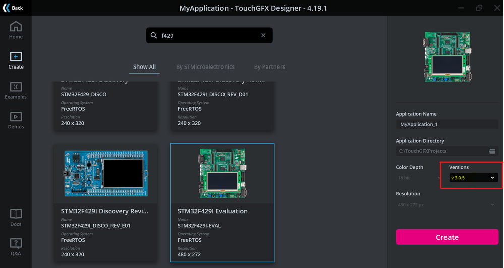

I mean this version here (in TouchGFX Designer)
And for that 3.0.5 version, the STM32F429I-EVAL board is indeed configured to be using 6.4 version of STM32CubeMX. That's not Designer which configures it, but us, TouchGFX Team.

The version of TouchGFX Designer and CubeMX are still the old ones because in the source code of our board configuration it's still these ones. So for the future version 3.0.6 of STM32F429I-EVAL board, we will update CubeMX version and TouchGFX Designer version. This is also what the "migration" popup does in a way.
