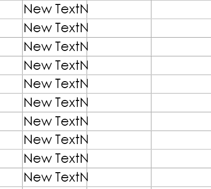

ellipsis character doesn't work
SLuo.2
When I put a long text in a small text area, the ellipsis doesn't appear, and the text is directly truncated,version is 4.19.10693W00000LygoqQAB.png0693W00000LygolQAB.png

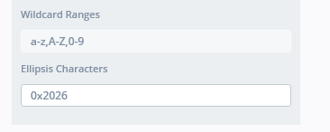

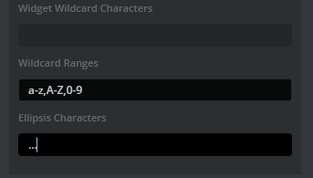

  • In your TouchGFXDesigner screenshot, I noticed that you wanted to print three-dots "..." character. Unfortunately, only one character is allowed for ellipsis. But, if you really want to display those three dots. you can write "0x2026" in this field, which is the hex code for those symbols.0693W00000Lyj8nQAB.png

oh,Thanks!
Is because I ignored the setWideTextAction() function.
