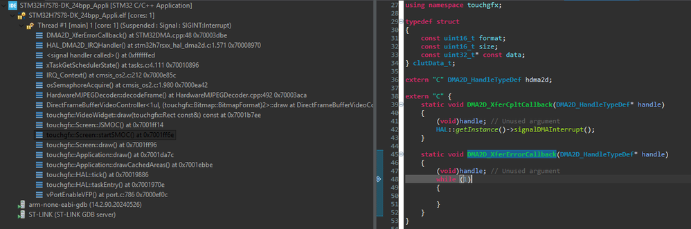

Hi again @ferro I found another bigger problem with rotation. If I add a mjpeg (avi) format video and use rotation feature, it stucks at DMA2D_XferErrorCallback.
By the way in this project XSPI channels are swapped with same pin configuration.
