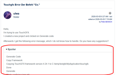

I'm trying to use TouchGFX.
I created a new project and clicked on Generate code.
Afterwards I get the following error message, which I do not know how to handle. Do you have any suggestions?

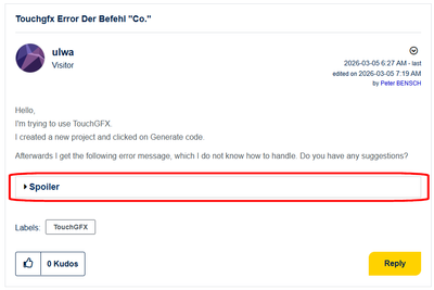

Why did you put the output log in a 'Spoiler' tag?
Where would you put the output log?
Use the 'preformatted' option - see here.
Or just plain text.
