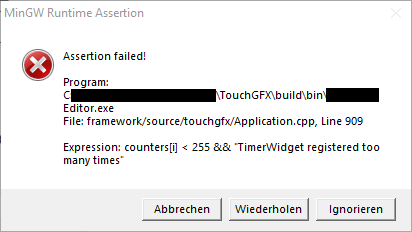

TouchGFX Simulator Assertion "TimerWidget registered too many timers"
Running my application in the Simulator, after a few seconds on a screen with a ScrollList I get this assertion. Can anyone tell me what components use excessive amounts of these timer objects, so I can try to work around it?
The same code running on the target runs fine.
The ScrollListItems have several MoveAnimators, but only a few of them are running an animation. Do MoveAnimators use TimerWidgets?

With great help from @GaetanGodart we sorted this (almost) out. I'm still not sure if this assertion is a bug (more likely) or a feature (timebomb?) inside TouchGFX Simulator framework code, but I can use the ScrollList as planned without getting the assertion. I will explain what parts of my code caused this assertion and how I changed it. Maybe this helps other users, when seeing the same assertion while running the Simulator application.
Contrary to what I first thought, the MoveAnimators did not cause the problem.
I have code that updates the content of all my ScrollList's items every second, because the information shown on the items could have changed (yes I know...:face_with_rolling_eyes:). My function to trigger the item-update-callback for each item of the ScrollList looked like this:
void MyView::updateList(uint16_t size)
	scrollList.setNumberOfItems(0);	//workaround update bug
	scrollList.setNumberOfItems(size);
	for (int i = 0; i < scrollListListItems.getNumberOfDrawables(); i++) {
		scrollList.itemChanged(i);
	scrollList.invalidate();
When calling setNumberOfItems(0) while the ScrollList is not scrolled up to the top item, the "TimerWidget" counter gets incremented and after reaching a count of 255 I get the assertion. I'll explain next why I had the seemingly pointless call to setNumberOfItems(0) before setting the real size.
While developing on the target I had issues with some Items of the ScrollList did not update their content while scrolling through the list (mostly the last ones). I thought it's a bug of TouchGFX and played around with the ScrollList API and found out that setting the size to 0 at first fixed my problem. Now I understand why it helped and what I did wrong until now:
A ScrollList has a fixed number or DrawableListItems (typically number of visible list elements on screen + 2). In my for-loop I iterate over this count and thought itemChanged(i) would tell every DrawableListItem to trigger the item-update-callback. But I mixed the two indices the ScrollList is working with: One is the index of the DrawableListItems and the other one is the index to your list (counting up to whatever "numberofItems" your told the ScrollList to have. And itemChanged(i) expects an index to the later one.
Mixing those caused some of my items to never update. By resizing the ScrollList having it resized to 0 and back to whatever size it has, internally causes a call to the item-update-callback for each item on screen.

GaetanGodart
Hello @t.decker ,
I have used fadeAnimator and had the same issue (but if I remember correctly, I was blocked after 20 timers).
To bypass this issue, since my animations were kind of similar, I just used the handleTickEvent function to copy the fade values.
I guess you use your moveAnimator in a custom container that you include in your scrollList.
Maybe the simplest solution is to make your GUI a bit less good looking by simply removing your moveAnimator.
The correct fix is probably to fetch the amount scrolled and to set the x and y position of the element in your scroll list accordingly to never use the moveAnimator.

I have quite a lot MoveAnimators on this screen, but only one or two of them are animating when the error shows up. I use them with my "TextAreaMarquee" (see https://community.st.com/t5/stm32-mcus-touchgfx-and-gui/share-your-custom-widgets/m-p/678013/highlight/true#M37701) each having a MoveAnimator.
Having a ScrollList and some normally hidden custom containers with edit-functions for the ScrollListItems I may have about 30 MoveAnimators on the screen. No way I can get to the limit of TimerWidgets 255 with this (assuming a MoveAnimator only needs one timer). And the MoveAnimators are not animating most of the time, only when the text of the "TextAreaMarquee" is too long.
So I had situations where I got this error with only one active MoveAnimator. At the moment I don't get this error at all and I don't know why. Maybe there is a bug in the MS Windows implementation of this part of TouchGFX library? Because on the target I never had issues. Not sure how to debug this in more detail...

Hello @t.decker ,
It doesn't matter if the moveAnimators are active or not. If you add one (or a widget using one), it will use the timer at all time basically.
How many items does your scrollList have? How many moveAnimator is there per custom widget text slider?
To my knowlege, there can only be 20 timers fors fadeAnimators so there should also be only 20 timers for moveAnimators. I have checked the line 909 and it seems it counts the potential timers that you added to be over 255. Maybe we changed that recently (it didn't make any sense to be limited to 20).
Do you have a for loop where you add timers or something like that?
"At the moment I don't get this error at all and I don't know why."
I don't understand what you mean. You don't have the error anymore? What did you change? Something must have changed.
