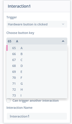

Hello @Leonhardt,
It's already possible to do so, when you create an interaction, with hardware button click you have a number and a character next to it :
The character next to it is the keyboard character that will simulate the button.
In the case of the image, the hardware button id will be 65 which is also the ascii char A, so in the sim clicking on A will simulate the behaviour of the hw button.
Edit : this is case sensitive so 65 = A uppercase (A when capslock / shift + A) and 97 = a lowercase
I hope it answers your question,
