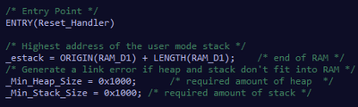

Are you sure you have dedicated enough space to the heap and the stack?
There shouldn't be a problem with the code of the application, and STM32H7 series are capable MCUs, so I suggest checking the configuration of your custom board. There is a good chance that the problem comes from the heap or stack size (For instance set them to 0x1000).

I have been trying setting more heap or stack size (like 0x2000..) before, but still not work.
