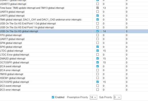

The solution has been the priority of the interrupts. Configuring them as follows:
I would like to know if this saturation is normal or if I am configuring something wrong?

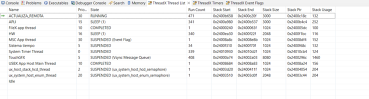

when the timeout occurs, this is the status of the tasks

Which is why I suggested using HAL_SPI_ReceiveDMA() and HAL_SPI_TransmitDMA().  With the polled HAL_SPI_Receive() that task is needlessly taking CPU time that other tasks could be using to do something (presumably) productive.

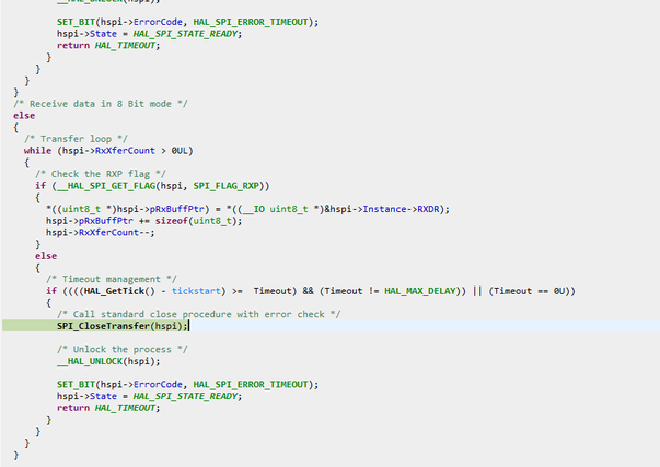

Though why that interrupt would affect receive and not transmit is a mystery.  Some thoughts:
  • In the most recent code you posted, how big is "buffer_spi"?
  • Are you SURE the error you are getting is HAL_TIMEOUT?  Your code above just checks for not HAL_OK.
  • I don't know about the H7 HAL code, but in the F4/F7 HAL_SPI_Receive() there are only 2 lines that can generate a HAL_TIMEOUT error: one for 8-bit data and one for everything else.  Set breakpoints on those 2 lines and see what the SPIHandle member variables look like.  Has it received ANY data?  If so, how much?
  • You say "continually skips timeout, even if I put more time on it" - are you saying that even if you change the timeout from 1000 to, say, 10000 (10 seconds), you still get the timeout error (and you have verified it is timeout and not some other error)?
[EDIT] Maybe possibly could be a memory corruption issue, but look at the previous items before chasing this.
It can be seen that it has received some data.

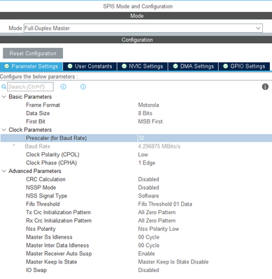

SPI configuration

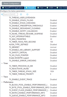

threadX configuration

> The interrupts I use don't take up much time.
That appears to be false since disabling an interrupt makes that code work.  Or an issue with the tick timer, see below.

Have you verified that the HAL tick timer is indeed running at 1000 interrupts/sec?  I don't know how ThreadX/Azure handles things but with FreeRTOS, the normal SysTick timer is used by FreeRTOS and the HAL systick related functions (HAL_GetTick(), HAL_Delay(), etc.) must us one of the regular timers (TIM7 typically).  If whatever timer is used by HAL_GetTick() is not counting much faster than 1000 Hz that would explain your problem.  So verify that calling HAL_Delay(1000) really does delay for 1 second.
**IF** HAL_Delay() really does delay for 1 second, then it appears your system is pretty close to saturated and cannot handle the overhead of an interrupt-per-byte on the SPI.  In that case, changing the SPI to use DMA might be your only solution (as I've mentioned before).
[EDIT] See this post for Azure SysTick vs. HAL : https://community.st.com/t5/stm32-mcus-embedded-software/stm32u5a5-azure-rtos-and-1ms-ticks-how-to-set/m-p/638541/highlight/true#M45282

You might be able to change the interrupt priorities to make this work, I'm not sure.  Are all of your interrupts currently at the same priority?  If so, that is not the best.  There are certainly SOME interrupts that are more crucial than other interrupts.
