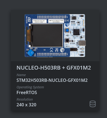

5.  support for h/w keys to control menu and screen ? this is one of the key requirement for our design as the design will be based on  hardware buttons/keys( upto 8 ). this product will not have touch screen.
TouchGFX does not support hardware keys natively because it is meant to be handled by the main.c.
It is very easy to interface hardware keys using STM32 and TouchGFX.
You can look at some of our TBS (TouchGFX Board Setup) such as the ones using the GFX01 display that are not touch and therefore use a joystick to interface :
