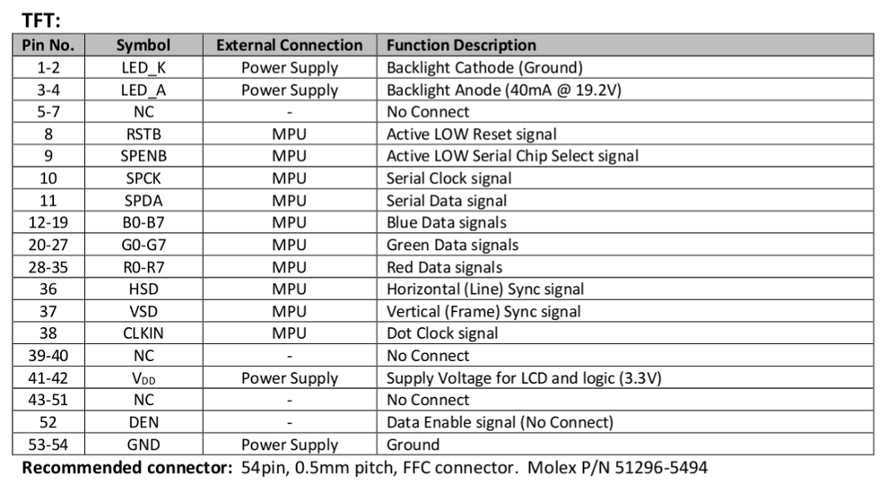

i have to move from dev board to final product still on STM32F429 but the 320x240 display has different controllers: NV3035C & FT5426
the link will still be RGB (maybe RGB666) with Hsync e Vsync (is clk needed too?) as per the LCD pinout here: 0690X000008B6a5QAC.png

Are you using the NV3035C in a serial (8bit) or parallel (24bit) setup? Probably the last since you're on an STM32F429.
Which display do you have currently? The hints given in that article are correct - If you're already coming from a parallel RGB setup then it will be an easy switch since you basically just need to get the display configuration right (porch configuration, pixel clock, etc) and get your VSYNC interrupt going which drives TouchGFX along.
