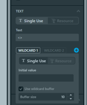

 On https://touchgfx.zendesk.com/hc/en-us/articles/205443982 the variables textCounterBuffer and TEXTCOUNTER_SIZE are used in snprintf.
 If I'm not mistaken, those variables are not available in TouchGFX 4.10.0. Is that correct?

If you add a wildcard to the textArea and check the "Use wildcard buffer" option they should get generated in the ViewBase class for that screen.
Screenshot:

thank you, nice catch! :)
