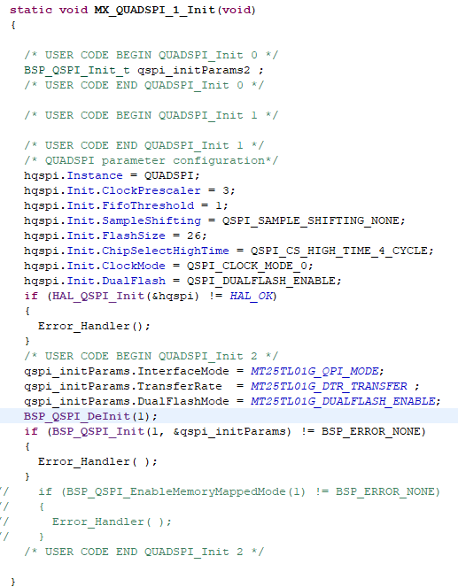

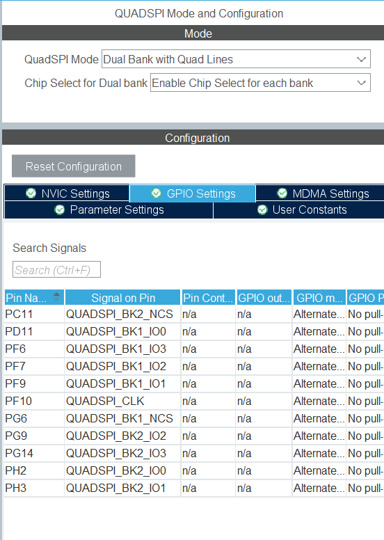

Thank you for your clear explanation. As you said, I removed the memory mapped mode part for qspi, but while doing this, I saw that there are 2 flash instances for this card. I wonder if this part is completely separate flash from touchgfx?
0693W00000aICjXQAW.pngActually my data is really small I just want to save 10 uint16_t variables, when user power off and power on the device, the numbers and choices must be saved.
0693W00000aICjcQAG.pngAnd for the eeprom emulation, there is no another sector in the flash.
Thank you again
SPozz.1
Check the stm32h750b-dk board schematic, Page 11, you will see U2 and U1, each chip over it's own bus.
So, the QSPI is in dual bank mode. The data are fetched 8bits at a time to double the speed. You shoud disable dual flash mode and than write/read using only one chip.
