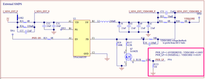

1- it says you need to use PF4 to kick the processor in overdrive.  Does PF4 need to be used (ie special function) or can any GPIO be used? (ie is PF4 just used on the STM32N657-DK board)?
Any GPIO could be used on a custom hardware, but on the DK board the PF4 is the one connected to the feedback on the regulator that allows the voltage change. Please refer to the schematic> https://www.st.com/resource/en/schematic_pack/mb1939-n6570-c02-schematic.pdf , page 5:
