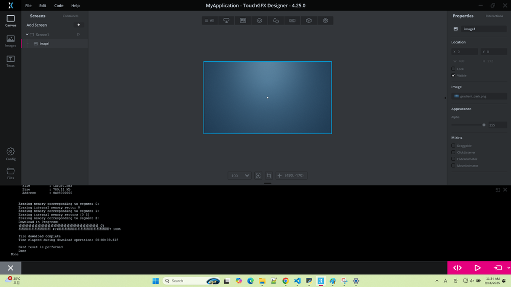

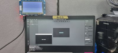

When I downloaded the simplest images to the board (for example, just a plain white screen or a solid color), the screen displayed the color correctly. But when I uploaded the photo I wanted, the entire screen became corrupted.
I conducted several tests: adding text only, trying the provided clock image, using a 480x272 image, adding a diamond shape on a solid background, and so on.
Only two cases were successful: displaying a solid color, and displaying a diamond shape in the center. In all other cases, the screen became corrupted.

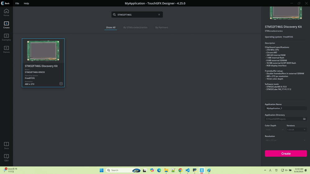

Here is my development environment:
  • Board: STM32F746G-DISCO : DK32F746G-CU4
  • TouchGFX Designer: 4.25.0
  • STM32CubeIDE: Version 1.6.0 / 1.19.0
  • Windows 11 Pro
