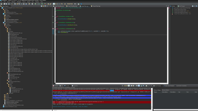

Hello there, I was working on TouchGFX and when i tried to build my code i got
error: no declaration matches 'bool TouchGFXHAL::blockCopy(void*, const void*, uint32_t) and same for endFrame and beginFrame.
But i couldn't solve the problem.
Here is the part from TouchGFXHAL.cpp file.
bool TouchGFXHAL::blockCopy(void* RESTRICT dest, const void* RESTRICT src, uint32_t numBytes)
return TouchGFXGeneratedHAL::blockCopy(dest, src, numBytes);

And the exactly error codes is here:
TouchGFXHAL.cpp:156:6: error: no declaration matches 'void TouchGFXHAL::endFrame()'
TouchGFXHAL.cpp:151:6: error: no declaration matches 'bool TouchGFXHAL::beginFrame()'
error: no declaration matches 'bool TouchGFXHAL::blockCopy(void*, const void*, uint32_t)'.

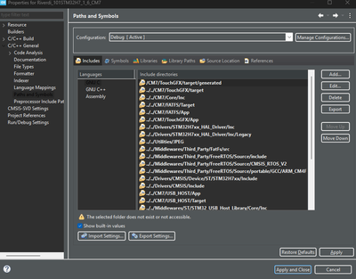

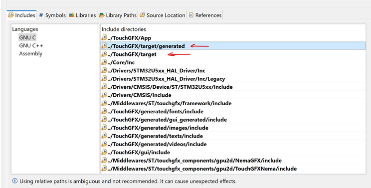

Hello @TahaBugraa and @JamshaidUsman
I'm really sorry for the late response @TahaBugraa
Could you please check if the headers are correctly added to the Includes under Paths and Symbols in your project properties -> C/C++ General?
These two should be available.

JamshaidUsman
I just include the project path to the MCU GCC compiler, and its working fine.
Thanks for your help.
