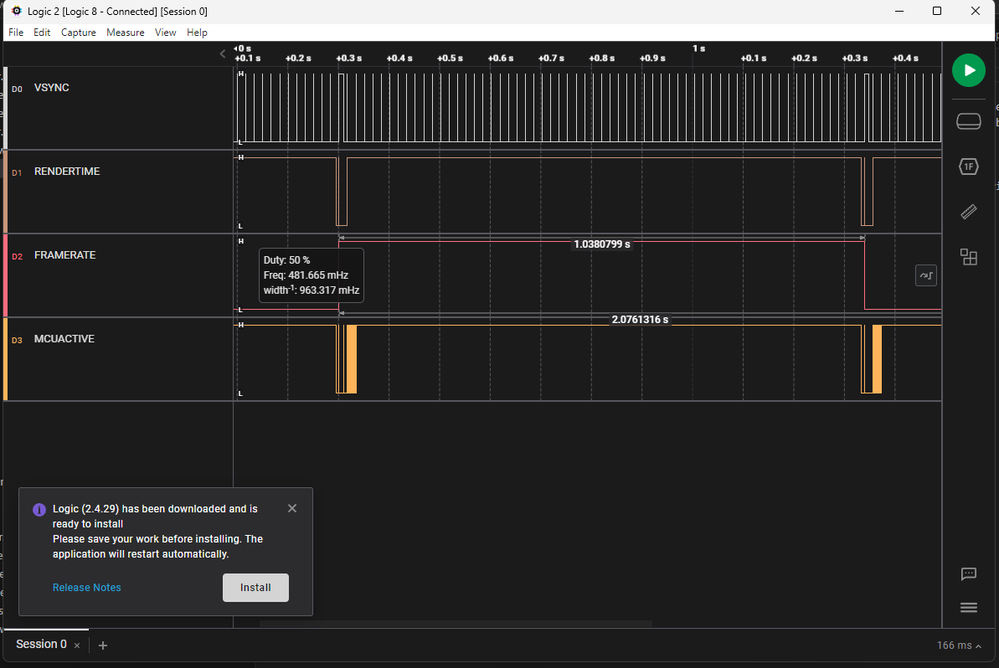

Here are some performance measurements from that:

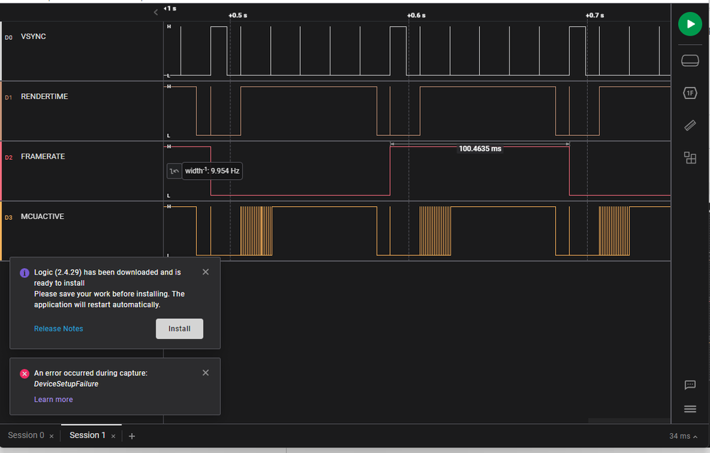

This shows that for me, the acutal rendering of each screen takes almost 1 second when adding a data point every other tick. At the same time, the MCU is active during that entire period.
So basically, the MCU cannot handle the graph.
As I state earlier, the graph widget is surprisingly heavy to render, because all the points need to be connected. When using the scrolling graph mode, this is even worse, because all the points need to be updated every time a new point is added.

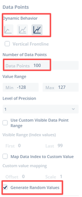

When using dots instead of lines in the "Elements" section of the graph, perfomance increases significantly, but the graph is pretty much ureadable with 300 points in the graph, and performance is still far from 60 fps:

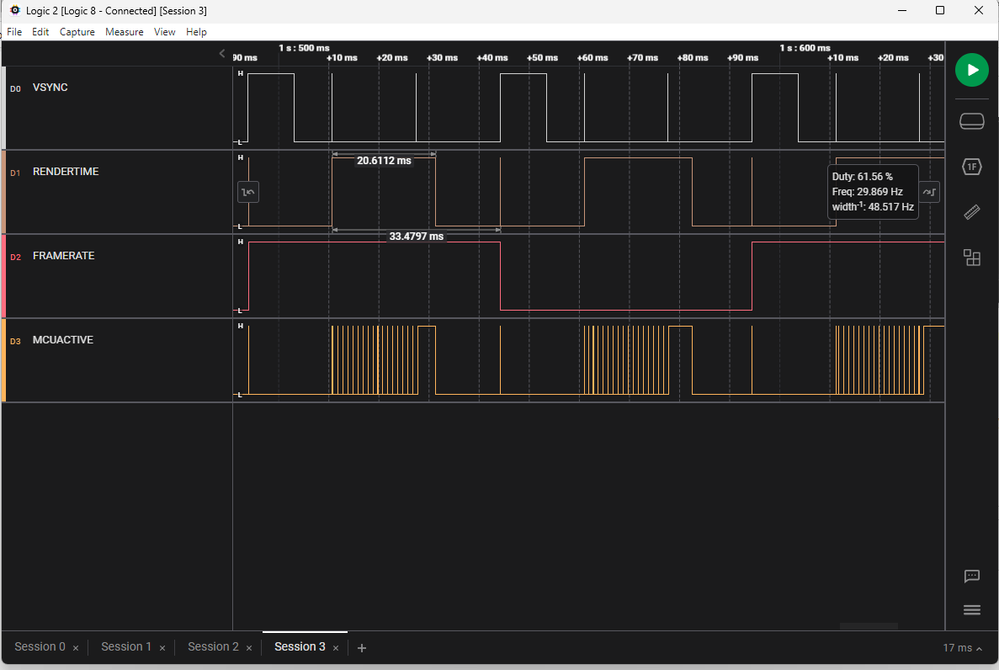

Going back to lines, and using the "wrap and overwrite" mode of the graph and using a vertical frontline with a width of 4 pixels to make it easier to determine where new data is input, it gets pretty close to the 16 ms you need for 60 fps:
In this mode, there is practically no gain to be had from changing to points or altering the number of elements.
So the conclusion must be that if you are going for 60 fps and the graph is necessary, the F469 is not powerful enough for your application.

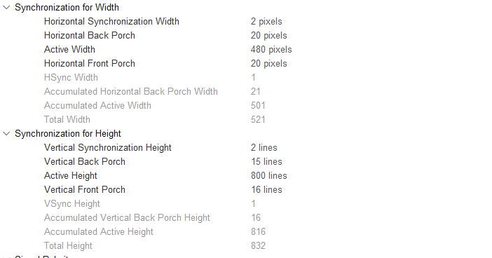

Other than that, your LTDC is not set up according to your table, which may be the reason you only see 40 fps when not adding points to the graph. What you want is this:
And an LTDC clock of 26.37 MHz. If you cannot get that clock, you can lower the porches as long as they are above the minimum values specified in your table until the timing is right.
